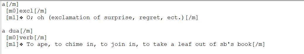

So, assuming this text :
a dua[/test] [k0]verb[m] [m1]❖ To ape, to chime in, to join in, to take a leaf out of sb's book[/bla bla]The following regex S/R :
SEARCH
(?-s)(^\h*\\[(.+?)\\].+|)\\[.+?\\]$REPLACE
?2\1[/\2]would give :
a dua [k0]verb[/k0] [m1]❖ To ape, to chime in, to join in, to take a leaf out of sb's book[/m1]

@guy038 I don’t know how to express my thanks for your quick and effective answer. I spent a whole day looking for the answer on the Internet, but in vain.
As for your explanation, I have tried to figure out, but understand very little. But when I used the syntax you gave and carried out the task (with some sense of uncertainty) - it worked like magic. Now, I can formatting each line (text color, bold type, etc.) as I wish.
Thanks again.
