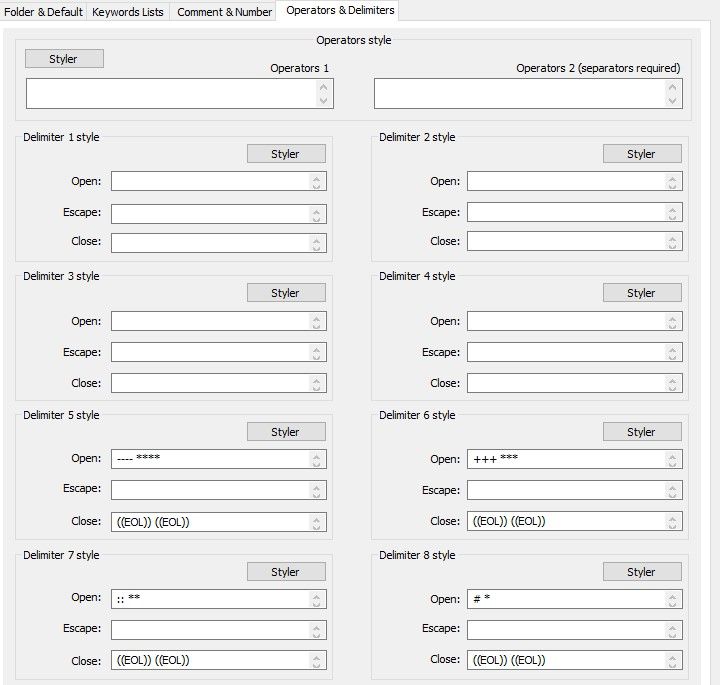

      In the delimiter section i defined * as a delimiter. But if i do that then ** *** **** delimiters etc. all take the properties of the * delimiter. Nesting does not help. Am i doing something wrong here or is this just how it works?

          Ok i figured this part out. So basically **** delimiter needs to defined first then *** then ** then * only then each of them will have different properties. Meaning you have start defining them backwards. Don’t know the technical reasons behind it though. Attaching a screenshot for more clarity.

            Ekopalypse @phenomenal11
            @phenomenal11
            The reason why you need to specify ** before * is that the
            lexer walks through the delimiter one by one and if it finds one that
            matches then it ignores the rest.
            But I don’t understand what isn’t working at the moment.
            Maybe another screenshot will help clarify this as well?
