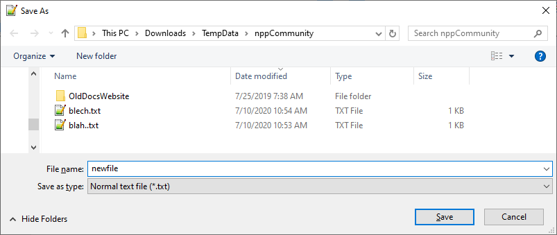

          Since v7.8.7, even the new-style applies an extension based on the selected file type in the save/save-as dialog. If you type no extension, it will take the first extension from the Save as type box:

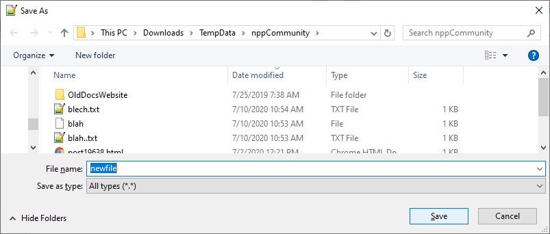

          Knowing that typing your own extension (like blah.ext) will override the auto-extension, I tried a trick of typing blah. to try to convince it to use an empty extension: as shown in the screenshot above, it still appended .txt to the filename, making it blah..txt, which isn’t what I wanted. However, if you then change Save as type to All types (*.*), and don’t type an extension, it will save the file with no extension.
          It’s a little extra work, but that will enable you to save a file with no extension. (Alternately, change your workflow slightly: create the file in Windows Explorer with no extension, then right click and open-with Notepad++ or drag the file into the open Notepad++.)
