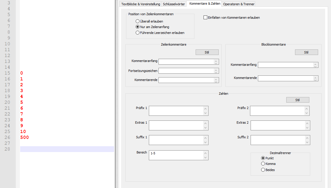

      Hi Guys,
      I’m working long time with Notepad++ and it’s a great tool. Today I’ve started do define an UDL for an internal used skript.
      It all works fine until I want to define the Numbers…
      The goal is to highlight all Numbers without 0 in RED
      • So Highlight all in RED (this is easy and was done by define the Style in the section Numbers)
      • Don’t Highlight 0 (that’s the hard one…)
        I’ve used the Range to advice unsing only a special area, but wihtout sucsess. It seem to me that this command didn’t work anyway (see screenshoot of a test)
        I’ve tried as well 1::5 or 1->5 like deskripted by Ivan (https://ivan-radic.github.io/udl-documentation/numbers/) but without sucsess
        The other stuff like Präfix or Suffix works…
      scond level would be If I would be able to have all Numbers in RED and the 0 in GREEN. I tried to use Keywords (like I’ve done it before for some comands), but It looks like this didn’t work with Numbers.
      I hope someone can show me an easy solution for this
      Thanks in advance
        Hello, @hans-gerch and All,
        The Range field ( Bereich ) is not intended to define the range of numbers
        It’s just a kind of suffix-prefix symbol(s) which will be highlighted, like the numbers placed right before and, possibly, the numbers located right after
        For instance, if that Range zone contains - :: __ ( a single dash, a double colon or a double underscore chars ), this means that, for instance, all the strings, below, will be highlighted in red
        2-0.5
        100::47
        0.003__7.785
        0000::
        Now, I’m not very acquainted with UDL and I don’t see an obvious way to distinguish the digit 0 from the other digits ! I’m afraid that it cannot be do with the native N++ UDL feature.
        However, you could use an enhanced UDL lexer, which could manage, differently, the 0 digit from the others. Two conditions :
        • Firstly, install the PythonScript plugin ( last version 1.5.4, using Python v2.7.18 )
        • Secondly, use the EnhanceUDLLexer.py Python script, created by @ekopalypse, from that post :
          • https://notepad-plus-plus.org/community/topic/17134/enhance-udl-lexer/31
