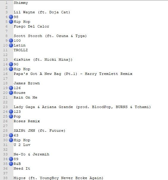

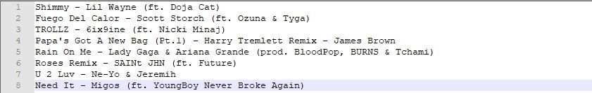

    How to suceed these actions in notepad++ (images included)
    19 Posts 4 Posters 993 Views
      Terry R
      @DJ-SpirosG said in How to suceed these actions in notepad++ (images included):
      if the text looks like that
      Before I supply anything I see you haven’t read that FAQ I mentioned. I welcome the “text” based example, however from the image you also supplied I can see the 2nd line is indented. That could be a number of spaces or a tab. The markdown language has interpreted and changed your text based example, thus removing the tab or spaces in front of every 2nd line.
      I point you back to the FAQ post and specifically the portion mentioning how to insert text using the 3 backtick and z character, then the example and followed by the 3 backticks again.
      How about you try and provide the example again using that formatting.
      DJSpirosGD 1 Reply Last reply Reply Quote 2
      • DJSpirosGD
        DJSpirosG @Terry R
        @Terry-R You are right i didn’t read it (yet) and yes you are also right that the text i posted changed, there are two spaces in front of every second line. Sorry for that it was because i was trying to confirm that your script was correct.
        Am heading over to the FAQ right now.
        Thanks for the help, appreciated!

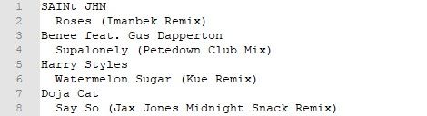

          Hello, @djspirosg, @terry-r and All,
          Ah OK, @djspirosg ! I succeeded to merge your two cases :
          • The song name is followed with a pure blank line, then, with the singer name
          • The song name is immediately followed with some leading blank characters and the singer name
          So, assuming this initial data :
          Song_1
          Singer_1
          Id_1
          Type_1
          Song_2
            Singer_2
          Id_2
          Type_2
          Song_3
          Singer_3
          Id_3
          Type_3
          Song_4
            Singer_4
          Id_4
          Type_4
          Song_5
          Singer_5
          Id_5
          Type_5
          Song_6
            Singer_6
          Id_6
          Type_6
          The regex S/R, below :
          SEARCH (?-s)^(.+)\R((\R|\h+)(.+))?
          REPLACE ?2\1\x20-\x20\4
          give us the expected data, too :
          Song_1 - Singer_1
          Song_2 - Singer_2
          Song_3 - Singer_3
          Song_4 - Singer_4
          Song_5 - Singer_5
          Song_6 - Singer_6
          Cheers,
