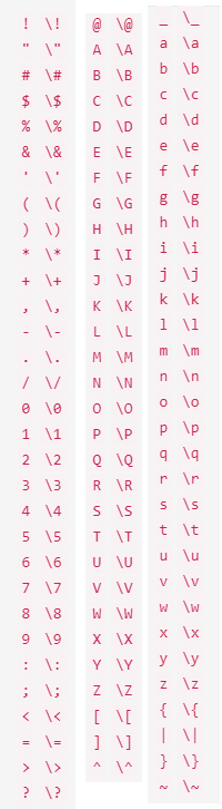

                I skipped the backslash-backslash pair, and the backslash backtick pair, because those both add another layer of confusion. The preview shows all of thse as I would expect:
                b17c5587-5e3a-4f44-af06-1347cd293649-image.png .
                Let’s see how it renders after posting…
                  @PeterJones said in Can I replace character with linefeedchracater in Notepad++ ?:
                  Looks like \\[ and \\] have special meaning in the forum’s markdown’s backtick implementation. Weird.
