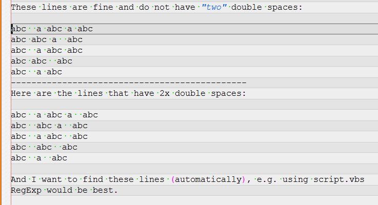

    I would like to find lines where there are 2x double spaces
    18 Posts 4 Posters 2.9k Views
    • Thomas 2020T
      Thomas 2020
      abc
      abc
      abc a abc a abc
      abc abc a abc
      abc a abc abc
      • Thomas 2020T
        Thomas 2020
        2x double space

                    Hello , @pan-jan and All,
                    I had to look at your picture several times to understand what you’re hoping for ! So, you want to find all the lines containing, at least, two strings containing, each, 2 consecutive space characters ;-))
                    However you don’t tell us witch process you intend to do with these lines :
                    • A Do you want to select all contents of these lines ?
                    • B Do you want to select all contents of these lines and their line-breaks ?
                    • C Do you want to find each double-space occurrence of these lines ?
                    • D Do you want to bookmark these lines for further process with the Search > Bookmark sub-menu ?
                    • E Do you want to delete these lines ?
                    • F Do you want to perform some kind of replacement in these lines ?
                    Here are the regex solutions for cases B and C :
                    Regex B (?-s)^.+\x20{2}.+\x20{2}.+\R?
                    Regex C (?-s)\x20{2}(?=.+\x20{2})|\G.+?\K\x20{2}

                    • Thomas 2020T
                      Thomas 2020 @guy038
                      Thanks.
                      I use AkelPad as the editor
                      and the pattern doesn’t work there … and not only there.
                      ^\w+\s\s.+\s\s\w+$
                      I thought I would see another solution here.

                          Hi @pan-jan,
                          Ah… of course, the provided regexes work only with the Boost regex engine, implemented within Notepad++ !
                          And I bet that specific regex syntaxes as \R ( line-break character(s) ) or the \G assertion won’t work with the Akelpad editor :-((

                          • Type in (?-s)^.+\x20{2}.+\x20{2}.+\R?    OR    (?-s)\x20{2}(?=.+\x20{2})|\G.+?\K\x20{2}, in the Find what: zone
                          • Tick the Wrap around option
                          • Click, repeatedly, on the Find Next button !
