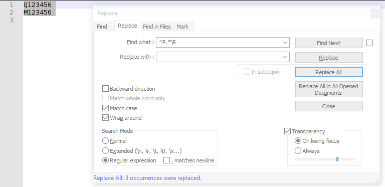

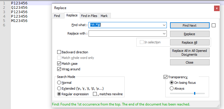

                  PeterJones @Fahad Alotaibi
                  @Fahad-Alotaibi said in delete all lines that start with specific litter:
                  I used what you said with notepad++ didn’t work
                  Then you did something wrong.
                  Before:
                  P123456
                  Q123456
                  P123456
                  P123456
                  M123456
                  Replace All
                  After:
                  Q123456
                  M123456
                  See, it deleted all the lines that started with P
                  If it doesn’t work for you, follow the same steps I just showed, including screeenshots.
