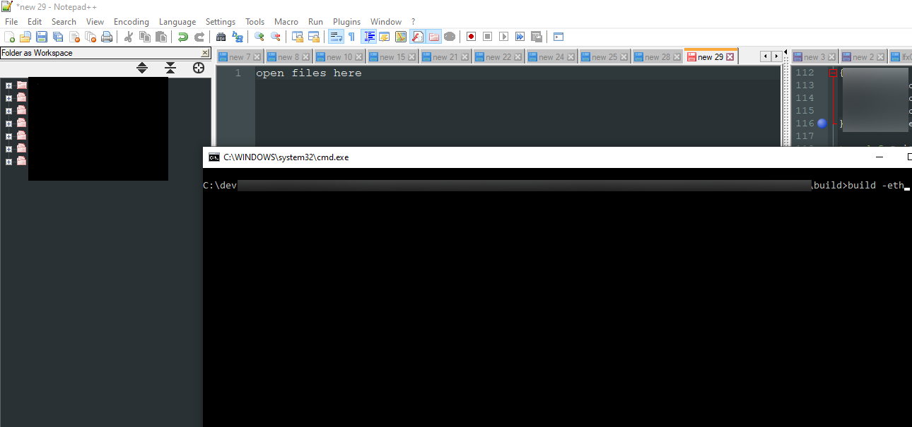

          Currently we compile from windows cmdline, it is done through a batch file (to generate build variables, run perl scripts as code generators etc). which goes to a single make file.
          Because we do embedded software, and have many targets and compilers, our batch script is made on the fly, as a concatenation of other batch scripts which depend on, folder location and also other compile time flags.
          ie something like,
          C:\dev…\src\applications\systemTestA\armv7mh743\gnuarm\someOS\NucleoH743ZI\build> build -eth
          and it appears that npp closes when one of the build flags is used, ( ie in my example above it was -eth, but that’s not actually the real option that closes npp ), so that kinda narrows the search, but it narrows it down to about 2180 files…

              The scripts are NOT executed via the run menu.
              Npp is open and in the background. the build is being executed in cmd.exe which is in the foreground.

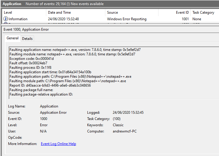

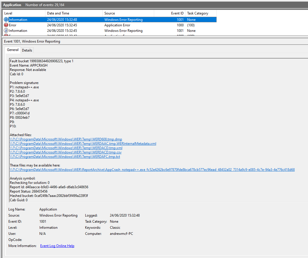

              eventvwr
              I have no experience with this, so i will post what i see.
