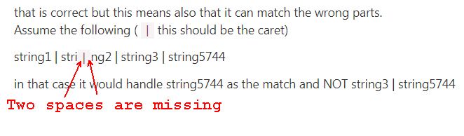

                    Ekopalypse @Thomas 2020
                    @Pan-Jan
                    the pattern works from the cursor position.
                    that is correct but this means also that it can match the wrong parts.
                    Assume the following ( | this should be the caret)
                    string1 | stri|ng2 | string3 | string5744
                    in that case it would handle string5744 as the match and NOT string3 | string5744

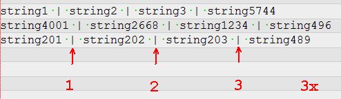

                      @Crimson-Virtuoso said in How to delete text after the 2nd specific character in each row:
                      string1 | string2 | string3 | string5744
                      string4001 | string2668 | string1234 | string496
                      string201 | string202 | string203 | string489
                      in this example there are 3 x |
