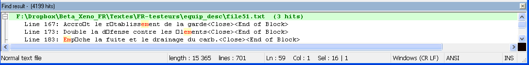

          Well, I forgot to say I’m using Windows 10 (the same issue is on Windows 7), and we are three users to get the same issue with the default settings. So I think this is a general issue. We can see the exact problem here:

              Ok, I’m on the 32-bit version of Notepad++ (64-bit version has the same problem) on Windows 10 64 bit (Windows 7 64-bit version has the same problem) and I’m using the default settings. And yeah, 3/3 users in the same case is pretty curious in my opinion, but maybe not for you, I suppose. I mentionned the last working version too (7.6.6). Everything is in its default state in the folders too with the default plugins.
              Here’s how it shows the issue: If I search for “rétablissement” in “Find in Files” with any filter and the default settings once again, no “rétablissement” is recognized in any file not opened by Notepad++ because the ‘é’ character itself is not recognized. The image above shows a □ character instead of ‘é’ if I just search for the term “em”, it’s the proof the versions above 7.6.6 don’t recognize the accented characters, or the ASCII extended ones if you prefer.

                                I just would like to add that the “Search result” doesn’t find anything if accentuated characters are searched for.
                                https://community.notepad-plus-plus.org/assets/uploads/files/1592392282525-notepad_isssue.png
                                You can see these squares because I put the term “em” to find. If I put “rétablissement”, the “Search result” panel doesn’t find anything, so I don’t agree with the “the file is currently seen in the Search result panel” part. Or I misinterpreted your phrasing.
