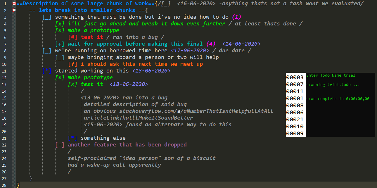

      Hi, im new here
      I’ve started working in this todo setup for the past couple of days which is just a bat file(for now) that sorts the tasks based on priority, due-date and task type (the performance was poor. now its handling 10k+ lines in ~2 secs).
      I ran into some issues while working on this
      • delimiter breaking the code folding. i did find a issue for this. so its is fine. i’ll just start folding at the beginning of the line
      • delimiter with a single line comment at the of the same line makes the delimiter highlighting go to the next line in search of ((EOL)). i couldn’t find any for this. am i missing something here?
      the last thing I want to display the tasks in the right-side panel as npp-task-list does but im afraid that i dont own a good setup to run something like MS Visual Studio. making a plugin is not on the table for me since i lack both the expertise and the fact that im hanging on a toaster doesn’t help
      so i looked into some other options like python scripter and lua script. i dont know how to code in these.
      I copied a line from here to make a clickable link but it shows something that looks as if im reading hexadecimal code
      I just want to make use of that text file and goto the lines in that order without having to switch between cmd and np++
      appreciate any help

        ah, i edited the time.py file in python scripter to print todays date. i think, i can now use regex to replace a “<[0-9]+>” into due date for convenience. but still cant figure out the clickable link part though
        I forgot to mention this before, does manually editing the udl.xml file to increase delimiters work?

          I’m not really sure what you try to achieve.
          Do you want to build the dialog on the right side, the one with 00003 … with clickable links?

            yes i want to create clickable links that take me to a line with the same number using that text file

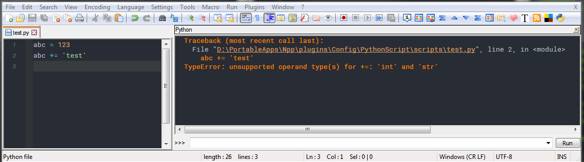

                wait, let me try to get this right.
                Your goal is to run a cmd/batch file and the result of that batch file
                contains links which you want to click and those will bring you to the location in that file, correct?
                Like in this example
                If I would click on the link in the Python console it would
                a) open the file test.py and
                b) set the caret to line 2
                Is it that what you try to achieve?
                jakimaJ 2 Replies Last reply Reply Quote 1

                  jakima @Ekopalypse
                  @Ekopalypse
                  exactly

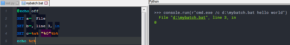

                    can i manually generate such links in console? using python scripter of course
                      Ekopalypse @jakima
                      @jakima
                      yes you can, assuming the following batch file
                      @echo off
                      SET a=  File
                      SET b=, line 3, in
                      SET c=%a% "%0"%b%
                      echo %c%
                      and calling the batch from either the console or via script with
                      console.run(r"cmd.exe /c d:\mybatch.bat")
                      would result in something like
                      and clicking on the link will do what I assume you want to do.
                      jakimaJ 1 Reply Last reply Reply Quote 3

                              Ekopalypse @jakima
                              @jakima said in Help with generating clickable links or something of that sort:
                              but… can python script directly interact with the text file to print to console?
                              yes, run it through this console.run(r"cmd.exe /c d:\mybatch.bat")
                              it will redirect the output of the cmd window to the console window.
                              jakimaJ 3 Replies Last reply Reply Quote 3

                                  it works as expected.
                                  sure, i have to figure out the iterating over notepad part. but yeah, it works!!!

                                    I figured out the iterating part and found some other things while at it
                                    • the output from the bat has to be on a new line or it wont work
                                    • you dont necessarily need the “, in” part in the second variable ‘b’
                                      Ekopalypse @jakima
                                      @jakima
                                      Yes, it must start with <space><space>File<space>" to be identified as an “linkeable” string
                                      and then it reads the rest of that line to see what kind of informations are available.
