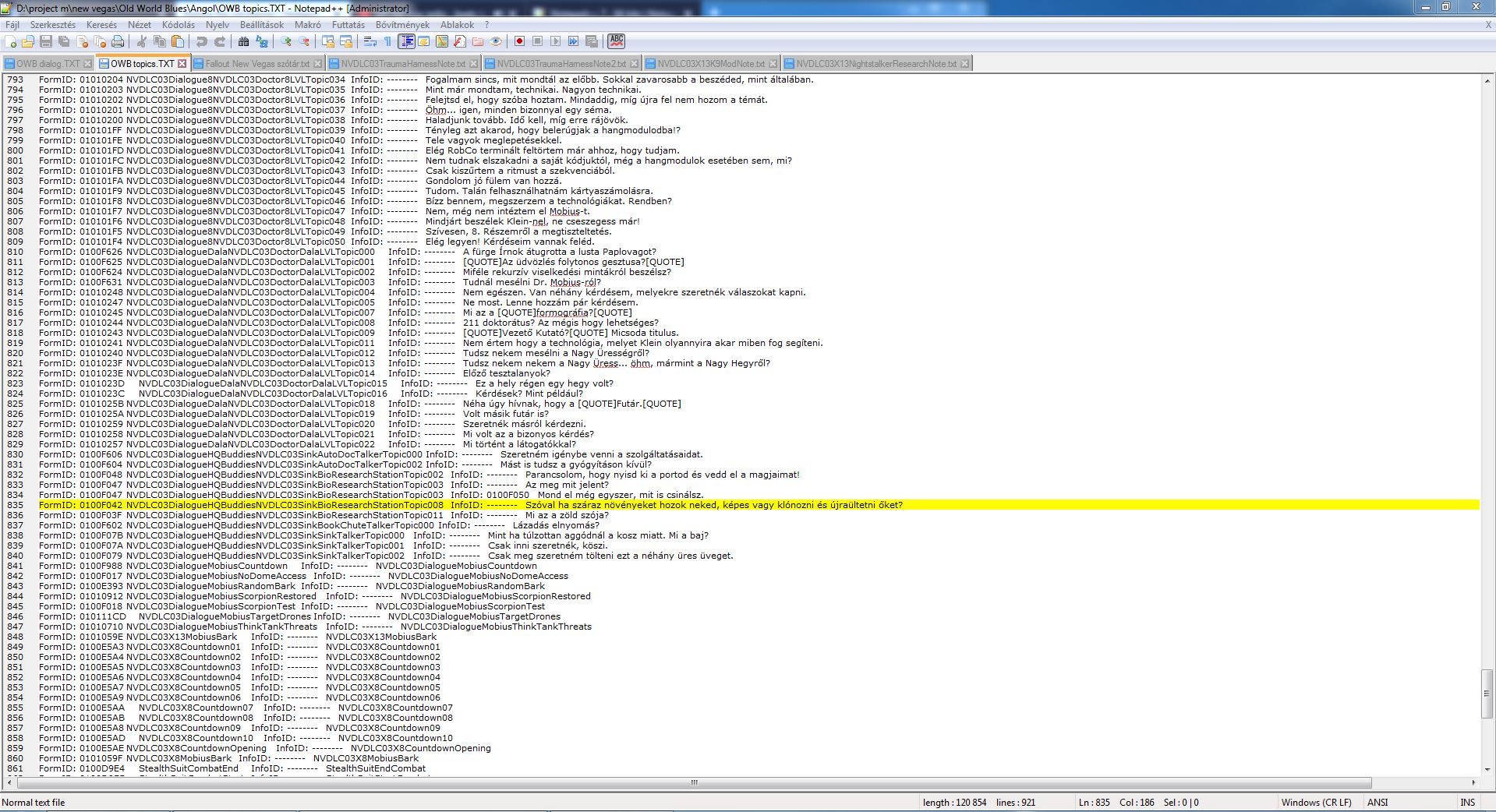

      I recently updated Notepad++ after several months and the editor now uses a smaller font size with an additional yellow line marker. This combination really hurt my eyes, and i want to change it back to the original larger, light blue style but i cannot find it anywhere. How can i change it back if there is any way to do that?

                Before the program updated itself i never even touched the Style configurator, so i guess i always used the default one. I choosed the XML: DEFAULT right now just to try out if anything changes (because it seems opening any .xml file brings back the old style) but even after saving the changes nothing happening.

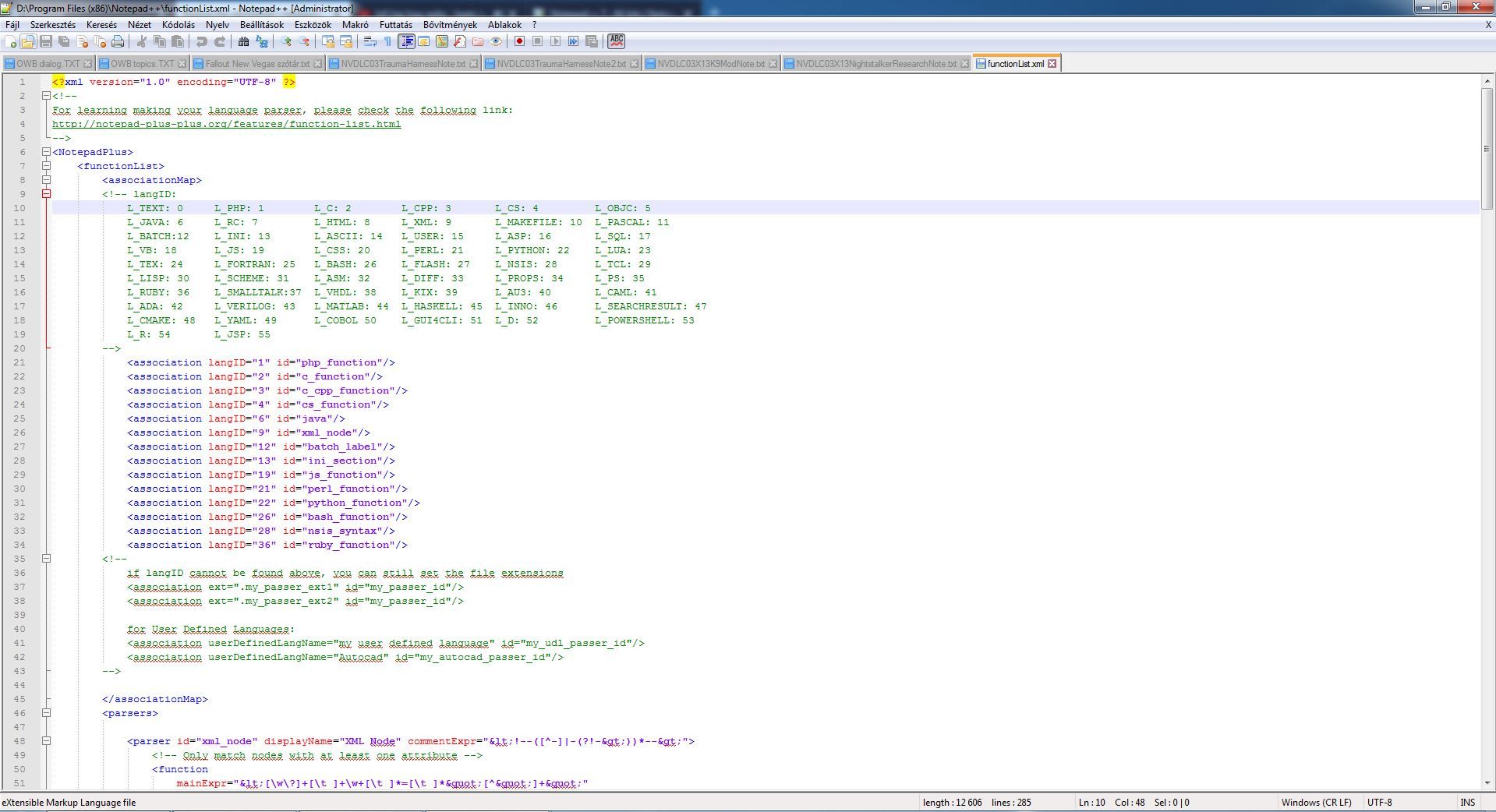

                I deleted the config file from the Appdata folder (because i didn’t have it in the installion folder) but that neither changed anything, as i previously said. I previously used the 7.5.2 build (which is back from november 2017 if i’m right) and right now i’m using the most recent stable version. I will provide you two pictures about the current default color theme:
                and the one which i want to use in every document:
