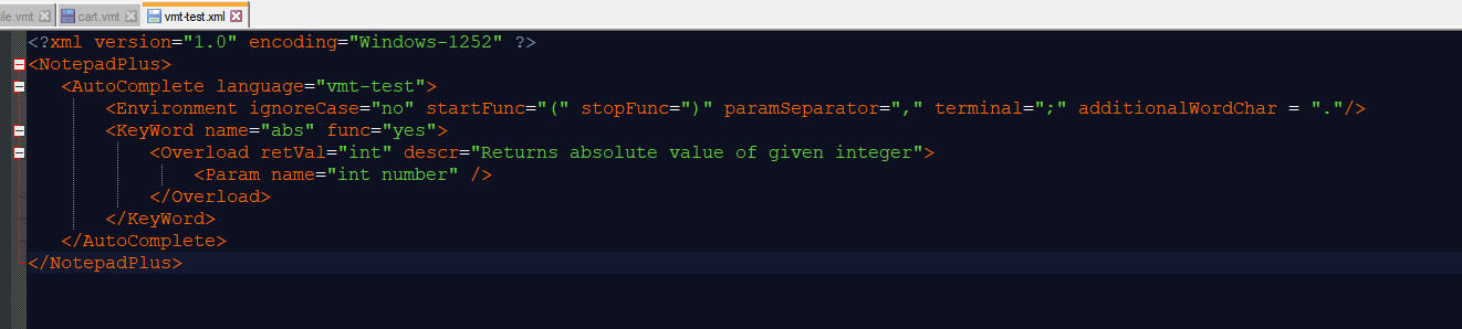

      Hello, I’ve tried to make my own function and description for it, but the description doesn’t show up for some reason. Yes, I have “Function parameters hint on input” checkbox checked.a2dff39c-cd74-4d13-b0ef-759d43572294-image.png

        I think your autocompletion filename must match the language extension - so the “-test” suffix should be removed. Also you have specified that your function starts with open parenthesis:
        startFunc="("
        So you’ll need to type:
        abs(
        before you get any function hints.

              Oh, yeah, I see. Thanks ! I thought it’s gonna add the tip to the word itself. Like when you type “abs” you get a tip…
              Is it possible to do so though ?
              And is it possible to start my function with " ?
