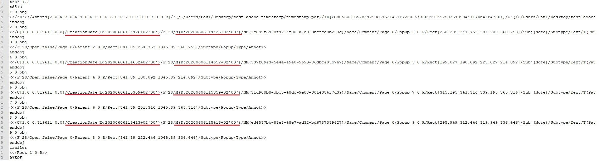

      I want to delete the timestamps on a Summary Comment page from a PDF. For now i can do it manually one by one: exporting the FDF data, rename as XML, open it with Notepad++ and search for those strings:
      code_text
      /CreationDate(D:20200605015359+02'00')
      /M(D:20200605015359+02'00')
      code_text
      numbers are the timestamp variable.
      and finally rename it as FDF.
      In fact since dont know how to code stuff, if someone is kinda enough im looking for a script that do the same thing without open notepad++.

          In Adobe DC it is possible to create a file with all comments written on the pdf documents, it’s called Comment summary:
          https://helpx.adobe.com/acrobat/kb/print-comments-acrobat-reader.html
          What i want is delete the comment timestamps on that file. It is possible exporting the comments metadata as .fdf file.
          Change extension to .xml and it looks something like this:
          Now for every comment delete the two strings:
          /CreationDate(D:20200605015359+02’00’)
          /M(D:20200605015359+02’00’)
          The numbers are the timestamp that change everytime.
          The result should be like this:
          For now i do it manually, and i would ask the proper RegEx search line for searching all those two string and replace them with nothing, ie delete them.
          Since i have many pdf with hundreds comments, it would be nice if someone helps me writing a script that do the same job without replace them in notepad++.
          Thanks again

            I’d say this regex could match your situation:
            (?:/CreationDate|/M)\(D:\d{14}\+02'00'\)
            It seems like the +02'00' is constant, but if it is variable, we can deal with that as well.

                      Hello, first of all thanks everyone for the help.
                      I have tried the first proposal (?:/CreationDate|/M)(D:\d{14}+02’00’) from @Alan-kilborn and it works perfectly since i dont need the \x20 space char.
                      For some reason if i use the other proposals, Acrobat refuse to import the modified fdf file because an unspecified error.
                      Anyway, i resolved my problem now. I use this script to remove the autor name https://adobe.ly/3emVRkC and the search RegEx for the timestamp.
                      Thanks again.
