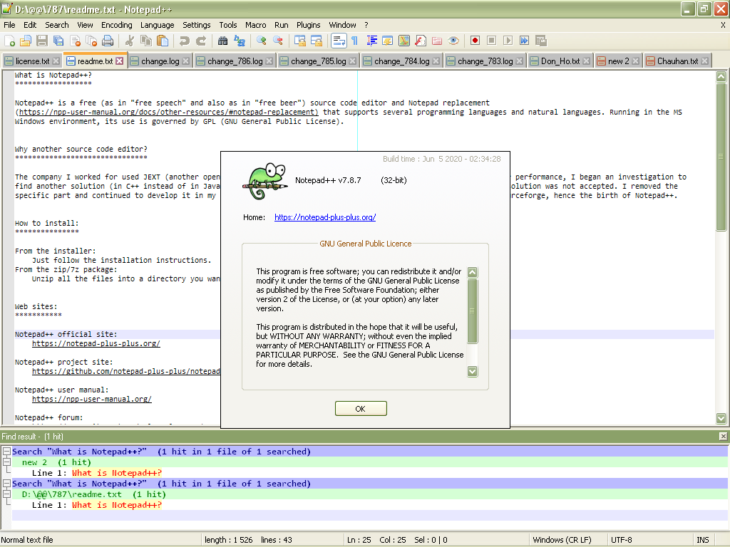

                Hi, @mr-chauhan, @ekopalypse, @alan-kilborn and All,
                Alan, I did not notice, in Notepad++v7.8.7, your points :
                • The English word Search has not been replaced with the French word Recherche, yet
                • Search of an single occurrence in one file only displays the right spelling !?
                Cheers,

                  @guy038
                  So I merged my existing english_customizable.xml with the changes from 7.8.7’s.
                  I did this as I usually do when upgrading, without paying too much attention to what the “new stuff” is; the important point is to not let my customized version of the file get too far “behind”.
                  Going back to it after noticing the pluralization I noticed these new translation strings near the end:
                  <find-result-caption value="Find result"/>
                  <find-result-title value="Search"/>
                  <find-result-title-info value="($INT_REPLACE1$ hits in $INT_REPLACE2$ files of $INT_REPLACE3$ searched)"/>
                  <find-result-title-info-extra value=" - Line Filter Mode: only display the filtered results"/>
                  <find-result-hits value="($INT_REPLACE$ hits)"/>
                  This seems to be the root of the pluralization even for non-plural data.
                  So my main point for the current thread is that in your solution you used the text Search, and this text may not be constant anymore. It will be controlled by:
                  I’m at a loss to explain this, as french.xml (for 7.8.7) seems to have the translations:
                  <find-result-caption value="Résultats de recherche"/>
                  <find-result-title value="Rechercher"/>
                  <find-result-title-info value="($INT_REPLACE1$ résultats dans $INT_REPLACE2$ documents depuis $INT_REPLACE3$ documents recherchés)"/>
                  <find-result-title-info-extra value=" - Mode de filtre de ligne : affiche uniquement les résultats filtrés"/>
                  <find-result-hits value="($INT_REPLACE$ résultats)"/>
                  So I guess in the end it is just a minor annoyance. Calling it 1 hits instead of 1 hit isn’t going to make me go demand that the developers change it back or even worse:
                  Have a Preference setting for it. <----- That’s a big joke, meant for people that want everything to be Preference configurable.
