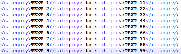

      I am doing XML edits in the software, but I want to edit certain patterns collectively.
      For example: As in the picture in this alt text link, I want to change the transcripts of 2 or more patterns at once in many open documents.

          Is it possible to explain with an example? what I want is exactly in the picture below. Each document has category tags with different inputs, and I want to translate these tags into one entry at a time. Sorry, what you wrote was a bit complicated.

            I asked for text, you gave an image. I asked for “before” and “after” data separately; you put the “before” and “after” in the same screenshot – and even on second reading, I didn’t realize that the to in your image was the change from X to Y indicator rather than part of your text.

            • FIND = <category>TEXT (\d)</category>
            • REPLACE = <category>TEXT $1$1</category>
            • Search Mode = regular expression
            (untested)
            I recommend you backup any files you try this on, and only try it on one file until everything is working.
            There are obvious assumptions in my example – that your text is literally TEXT every time, and that you’ll always only have one digit after text before </category> – but if my answer is not sufficient for your needs, you are going to have to do a better job of providing data that represents your data, and showing a willingness to learn.
