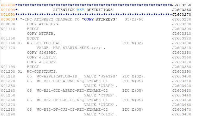

      Comment lines for COBOL do not display correctly in Notepad++ if there are any characters in column 6. By definition a comment line is any line with an asterisk (*) or slash (/) in the indicator area (column 7) of the line, and should not be dependent on any preceding characters.
      (https://www.ibm.com/support/knowledgecenter/en/SS6SG3_4.2.0/com.ibm.entcobol.doc_4.2/PGandLR/ref/rlfmtcom.htm)

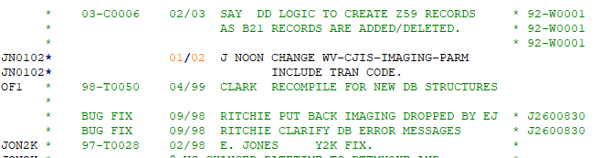

      The first three lines below are displaying comments correctly, but the fourth and fifth lines are displaying as active code rather than a comment. The sixth line and others following are again displaying correctly. The only time that the comment line is not formatted correctly is when there is a character in Column 6 and a comment indicator in Column 7.
      Eventually the formatting gives up:
      From this point on, for the next 11,000+ lines, there is no formatting at all.
      This program does compile, so the highlighting does not affect the actual code, but it is a frustration that the highlighting of Comment Lines goes funky.
      Would it be possible to correct the definition of a COBOL comment line? Is there somewhere I can change the highlighting myself to match the actual COBOL definition?
