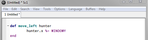

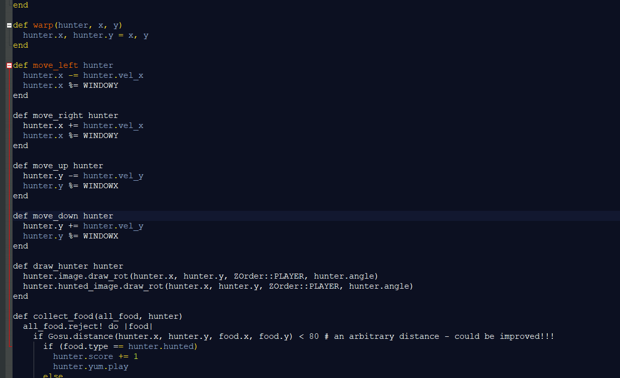

      Hey,
      For some reason when Notepad++ sees %=, it can’t figureout how to highlight stuff properly (as seen below
      How do I fix this?

            Ekopalypse @ice7512
            @ice7512
            quick info before I have to go back to work.
            Can confirm the behavior with my installation as well.
            Will check later if there is something which can be done to solve it unless someone else already jumped in.

                Ekopalypse @ice7512
                @ice7512
                Seems to be a scintilla issue because the demo editor (SciTE)
                is doing the same thing.
                And after searching scintillas bug tracker I found this.
                Not good news I’m afraid but please don’t shoot the messenger :-)
                ice7512I 1 Reply Last reply Reply Quote 3

                  @Ekopalypse Is there anything I can locally do on my machine to prevent this from happening?
                    Ekopalypse @ice7512
                    @ice7512
                    What you might try is to use something like this,
                    which means that you need to install the PythonScript plugin.
                    The limitation of this technique is that you can only define foreground colors,
                    and if you have really large source code files with lines > 10_000 and you fold a lot of code,
                    it will slow down your typing experience.
                    I use this every day with Python code, but my files usually don’t exceed 1_000 lines of code.
                    Other then that, you have to build npp and scintilla yourself and make the fixes in Ruby lexer.
                    Alan KilbornA ice7512I 2 Replies Last reply Reply Quote 1
