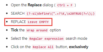

            The @alan-kilborn’s solution is valid but, just in case you’ve got some other zones , True in your file, here is a safer solution :
            • Open the Replace dialog ( Ctrl + F )
            • SEARCH (?-si)define\(".+?\K,\x20TRUE(?=\);)
            • REPLACE Leave EMPTY
            • Tick the Wrap around option
            • Click on the Replace All button, exclusively
            Notes :
            • Globally this regex searches, first, for the literal zone define(", with this exact case. followed by the shortest non-null range of standard chars. till the string ,\x20TRUE, with that exact case, but ONLY IF followed with the string );
            • The (?-is) in-line modifiers forces a non-insensitive search and a non-single line text, meaning that text is split in individual lines and that the regex meta-character . matches a single standard character only ( and not line-breaks )
            • The parentheses have a special regex meaning and must be escaped to be considered as literals
            • The \K syntax causes the regex engine to only retain the part , TRUE, which is deleted as the replacement zone is empty

                        Alan Kilborn @Program111
                        @Program111 said in Replace specific word between words in string:
                        where is step 6? the “Replace All”?
                        I don’t know what to put int he “replace” field
                        Perhaps “Leave EMPTY” is bad terminology, if it wasn’t empty in the first place. Instead try:
                        • put caret in Replace with box
                        • press Ctrl+a (to select all)
                        • press Delete

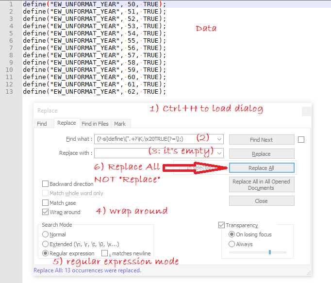

                            Maybe a picture will help:
                            If you start with this data:
                            define("EW_UNFORMAT_YEAR", 50, TRUE);
                            define("EW_UNFORMAT_YEAR", 51, TRUE);
                            define("EW_UNFORMAT_YEAR", 52, TRUE);
                            define("EW_UNFORMAT_YEAR", 53, TRUE);
                            define("EW_UNFORMAT_YEAR", 54, TRUE);
                            define("EW_UNFORMAT_YEAR", 55, TRUE);
                            define("EW_UNFORMAT_YEAR", 56, TRUE);
                            define("EW_UNFORMAT_YEAR", 57, TRUE);
                            define("EW_UNFORMAT_YEAR", 58, TRUE);
                            define("EW_UNFORMAT_YEAR", 59, TRUE);
                            define("EW_UNFORMAT_YEAR", 60, TRUE);
                            define("EW_UNFORMAT_YEAR", 61, TRUE);
                            define("EW_UNFORMAT_YEAR", 62, TRUE);
                            After you’ve hit Replace All, you will end up with:
                            define("EW_UNFORMAT_YEAR", 50);
                            define("EW_UNFORMAT_YEAR", 51);
                            define("EW_UNFORMAT_YEAR", 52);
                            define("EW_UNFORMAT_YEAR", 53);
                            define("EW_UNFORMAT_YEAR", 54);
                            define("EW_UNFORMAT_YEAR", 55);
                            define("EW_UNFORMAT_YEAR", 56);
                            define("EW_UNFORMAT_YEAR", 57);
                            define("EW_UNFORMAT_YEAR", 58);
                            define("EW_UNFORMAT_YEAR", 59);
                            define("EW_UNFORMAT_YEAR", 60);
                            define("EW_UNFORMAT_YEAR", 61);
                            define("EW_UNFORMAT_YEAR", 62);
                            If you ignore this advice, and just hit Replace, it won’t work.
