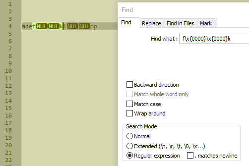

      @guy038 or anyone else with input:
      In the FAQ it is implied that current Notepad++ has a problem doing regular expression searching for embedded NUL characters via this statement, which might at first read be confusing because it is talking about the benefits of using a non-standard N++ version:
      “Both, search and replace strings can contain embedded NUL characters and/or Escape sequences for NUL characters ( \x{0000} )”
      But…I did NOT find searching for embedded NULs to be a problem with Notepad++ 7.8.6; am I missing something?

          Alan Kilborn @guy038
          @guy038 said in Regex searching for NUL characters:
          our present Boost regex engine do handle the NUL characters, but ONLY  in the search regex !
          Ah, okay; thanks for the confirmation on what I was seeing in practice!
          Is it clear that the FAQ entry is implying that the even a search does not currently work when that is truly not the case?
