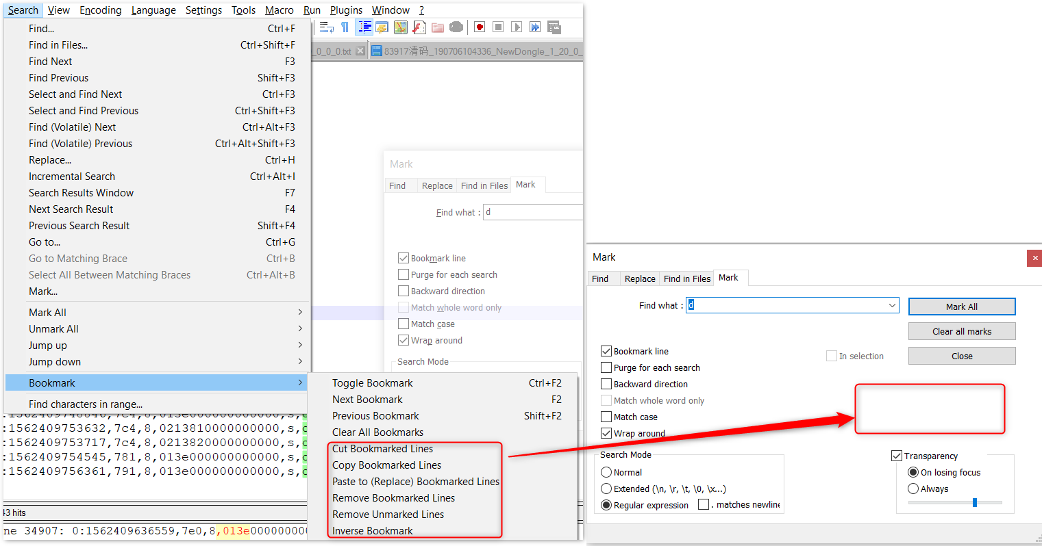

      Hi, Mark function is very useful to separate the require lines in the file. But the bookmark functions is put in Search/Bookmark menu. So I think it would be great if we have button for the bookmark functions in the Mark dialog.
        Alan Kilborn @Dat Tran Tan
        @Dat-Tran-Tan
        The Find family of window tabs has one job; to Find/Replace/Mark data.
        What one does with the data after that point is a separate functionality, and it is reasonable that it is in a separate place. My 2c.

            @Alan-Kilborn said in Actions for bookmark in Mark box.:
            It does seem sort of labor intensive to navigate the menus to get to the bookmark manipulation commands.
            I would agree. I think @Dat-Tran-Tan should follow the instructions in the FAQ to make a feature request. (In the past, sometimes a regular here would make the request for the person who originally posted, but there are certain recent statements by the developer that indicate feature-requests by random users, rather than by regular contributors, are given more weight.) And @Dat-Tran-Tan , remember to link to this discussion in your feature request, maybe summarizing some of the alternate implementations discussed here, and don’t forget to come back here and paste a link to the issue after you create it.
            burdening the Mark window with more bookmark functionality than Bookmark line seems misplaced to me.
            It makes it more crowded, yes; but the Mark tab only has 3 buttons so far, compared to the 5 in Find and Replace tabs.
            But maybe I am warming to the idea of a 5th tab “Bookmarks”(?) with buttons to activate these functions?
            I’m not sure it really needs a separate tab – having the action of bookmarking the lines on the Mark tab, but the actions performed with the bookmarks is on a separate “Bookmarks” tab could get annoying: analogous having to go to the Find tab to highlight the matches and then switch to the Replace tab to do the replacement, but then have to go back to Find again to highlight the next match before going to Replace to change the text.
            Personally, marking and bookmarking may have entered my toolbox earlier (and they are still barely in my common-use) had it been more obvious (like in the multi-purpose dialog box) what I could do with marked or bookmarked lines; having the actions buried in submenus not directly related to the marking or bookmarking creates a mental barrier to starting to use those features.
            As a compromise, maybe create one button “Act on Bookmarked Lines” that takes you to a second modal dialog which has the buttons for all the “Bookmarks” submenu actions; have that button only activated when the “Bookmark lines” checkbox is enabled.
            Or, if you really want a fifth tab, then remove the “Bookmark lines”, and have the action of setting bookmarks be in the same tab as the buttons that act on the bookmarks:
            Find What: ____________     [<<PREV][>>NEXT]
                                        [Bookmark All]
                                        [Clear Bookmarks]
                                        [Inverse Bookmarks]
                                        [Cut][Copy]
                                        [Paste Over Lines]
            You don’t really need a separate button for “remove bookmarked lines” vs “cut”, because cutting will remove those. You don’t really need a separate button for “remove unmarked lines”, because you could just “inverse bookmarks” then “cut”.
            edit: crossed out the “compromise” line; a second modal dialog might be worse than a fifth tab, and moving the bookmark action to be separate from the mark action makes more sense to me than a second dialog.
            Alan KilbornA 4 Replies Last reply Reply Quote 2

                      • Dat Tran TanD
                        Dat Tran Tan @Alan Kilborn
                        Probably not a lot of users use bookmarks (but who really knows); burdening the Mark window with more bookmark functionality than Bookmark line seems misplaced to me.
                        Hi @Alan-Kilborn
                        Why do you expect that a function is made but not used much ?
                        This bookmark function set is very useful for user who want to separate the the data.
                        I think putting Cut and Copy bookmarked lines buttons to the Mark box doesn’t make it a mess at all but make it a lot more handy.
                            @Dat-Tran-Tan said in Actions for bookmark in Mark box.:
                            It was just a guess, based upon how much “bookmarks” are (not) discussed on this forum, of course this is in comparison to what else is discussed, in terms of quantity.
                            There are probably plenty of functions in Notepad++ that got “made” but don’t see a lot of use; e.g. Document Peeker (uh, oh, now I will hear from all of the fans of that feature).
                            Clearly. That’s what your original post was about.
                            But is it the best approach? That’s what’s being debated.

                                      It seems the Notepad++ devs have arrived at a solution that is less complicated than some of those suggested here (especially my idea of a 5th tab).
                                      See HERE and notice point #2 of the 7.8.7 change log:
                                      2. Add right-click context menu to bookmark margin.
                                      While not exactly what the OP wanted, it certainly makes the bookmark handling commands easier to get to than menuing to them.
