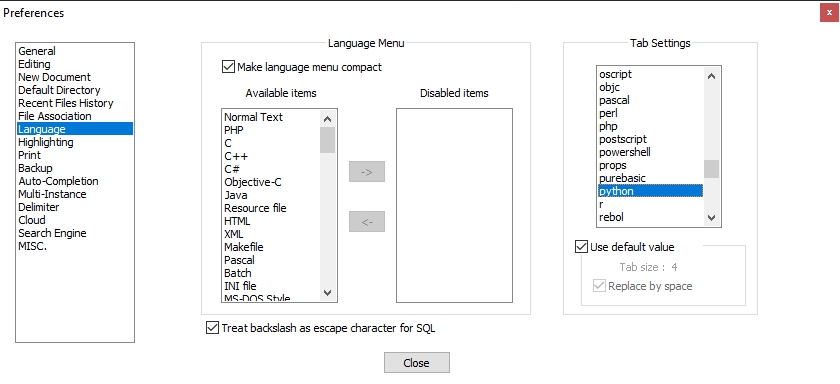

      Here’s a screenshot depicting the setting:
      Preferences, Language, Tab Settings, Use default value

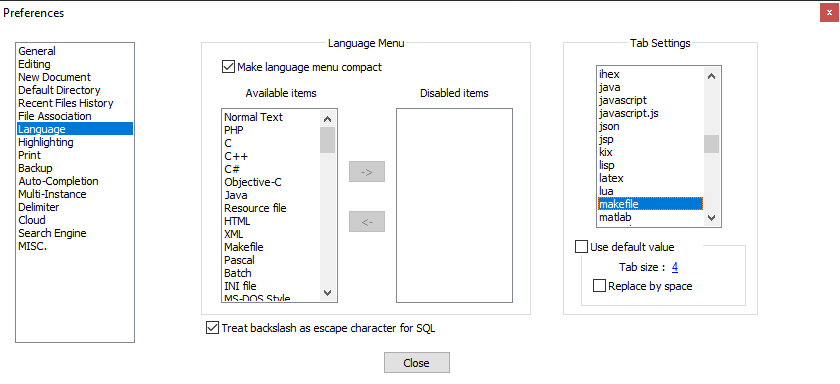

                          I use “Replace by space” “4” and only override that in Makefile:
                          That always stays for me opening and closing N++ and through reboots.
                          I think it stores it in $(NPP_INSTALL_DIR)\langs.xml
                          PS MVINCENT ~ > grep tabSettings C:\usr\bin\npp64\langs.xml
                                  <Language name="makefile" ext="mak" commentLine="#" tabSettings="4" />

                          You’ll notice Python and YAML are also in there because in a default install, they use tab and I “override” them to used the default (which I set to convert to 4 spaces):
