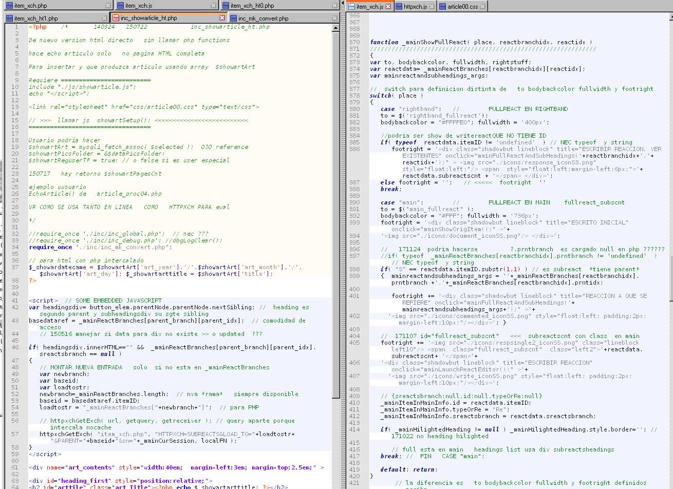

      Currently I have a project loaded in ver. 7.7 and I have managed to make it show the background I want for PHP and another background for Javascript. JS embedded is OK, but JS files are shown with the selected background only behind the lines with code. Empty lines and final spaces of lines are shown white. I don’t like it at all.

              Again, the problem is that when I set the background color in JavaScript, the same for embedded and regular file, embedded code looks well but regular files show the background color only close to the characters, blank lines and empty ends are shown white. That’s annoying .
              Funny thing is that for PHP both embedded code and regular files look fine, with their background color filling everything.
              Now I found an installation of NP++ ver 5.1 where that problem doesn’t show. In ver. 5.1 System Configurator > Language > Javascript doesn’t have also “Javascript (embedded)”. I’m thinking that problem started with new versions, offerening both options.
              I hope you understand the description of the problem above or can see the difference JS/PHP in the capture included.JS-PHP-backcolor.jpg I emphasized the blue in JS to make it more noticeable in this sample.

                  @Ekopalypse No, my only concern is with the background color in Javascript. It doesn’t fill all the background when a JS file is shown (left in my first picture). To the right you see a PHP file, background fills everything between “<?php>” and “?>”.
                  However, in embedded JS background fills everything between “<script>” and “</script>”.
                  In the past, with NP++ v5.1, we had Style Configurator > JavaScript to select colors, then we started to have Style Configurator > JavaScript (embedded) too. See new picture, with NP++ v5.1 background color fills everything in all JS code.
                  Now you see what is happening?
                  JS-PHP-backcolor-2.jpg ing in the newer versions?
                  Thank you.

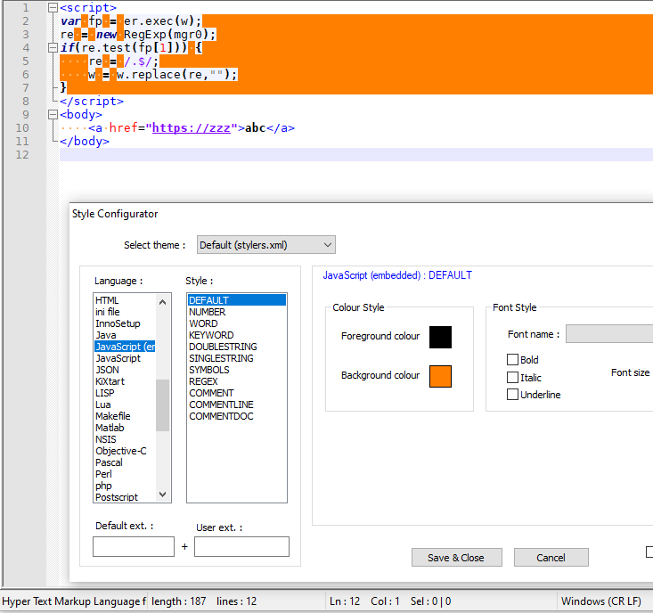

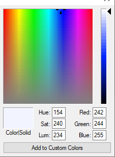

                    For javascript embedded, when there is a script inside an HTML or (per your experiment) PHP:
                    By default, they manually set every background to RGB=(242,244,255)
                    If I change one of them to orange, it works as expected.:
                    I would have to change all the backgrounds inside javascript (embedded) to completely change the background

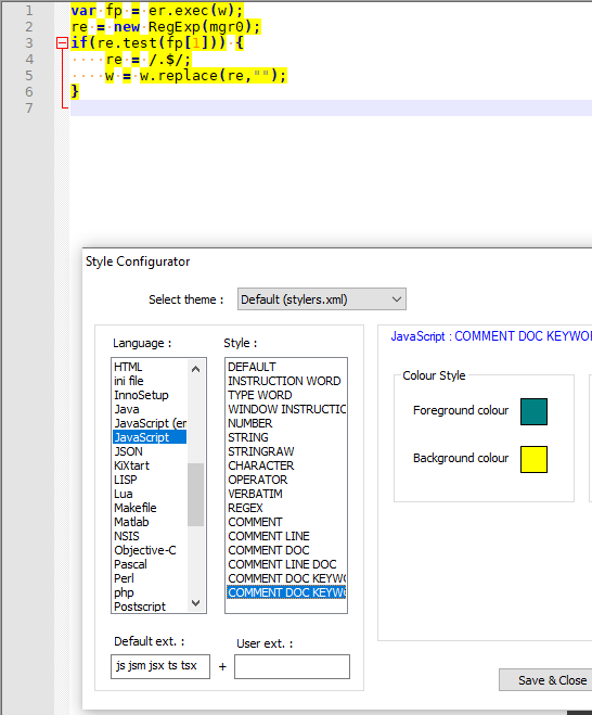

                    For pure javascript files (*.js), all the backgrounds are set to white; if you change just JavaScript > DEFAULT to yellow, only some will be backgrounded as yellow; if you change all the javascript styles to yellow (like shown below), then all of the .js characters will have a background of yellow, except empty space and unused characters, because that background is set by the theme’s GlobalStyle > DEFAULT style.
                    The javascript (embedded) was coded uniquely, to allow the JavaScript(embedded)>DEFAULT style to affect the background of the whole region including spaces and unused. The standalone javascript was not coded that way, because you do not need to highlight the difference between the <script> section and the non-<script> section in a file that’s completely javascript.

                      Sorry, in a Javascript file (not embedded, of course) one should see also blank lines and ends of lines with the same background that around characters. Do you see the effect in the left of my first picture? (I have set the same color for JavaScript > DEFAULT and everything there).
                      PHP files are shown with all background filled uniform (right of that same first picture). Why JS files would be different?

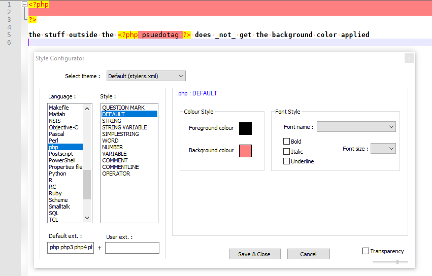

                        Sorry, I already said, “except empty space and unused characters, because that background is set by the theme’s GlobalStyle > DEFAULT style.”. The main background for a theme (whitespace and empty space) is set by the theme’s GlobalStyle > DEFAULT, not by any language-specific settings. So you cannot do what you have asked.
                        The source code in the “embedded-javascript lexer” (I assume it’s actually source code in each of the individual lexers like HTML and PHP which can handle embedded-javascript; as far as I know, there isn’t a standalone parser for “embedded javascript”) makes a special, unusual, non-standard exception which overrides the background even on blank/empty, for just the portions of the main file that are in embedded-javascript-mode; this is not something that the standalone javascript lexer does.
                        The whole point of the GlobalStyle > DEFAULT style is that it is the style that sets the background color for empty space, not any language-specific setting. That is core to the design of the syntax highlighter in Notepad++.
                        Oh, I see your confusion now. It’s because they aren’t shown with “all background filled uniform”. You just think they do because all of your PHP syntax occurs within the <?php … ?> pseudo-tag. Anything outside that tag does not get that background color, even though it’s not part of the same file.
                        JavaScript doesn’t have the same sort of all-wrapping tag around the source code that PHP has, so it doesn’t violate Notepad++'s intent of GlobalStyle > DEFAULT setting the background color for the whole document, and every other per-language style only making minor exceptions to that default. Personally, I would vote for PHP’s syntax highlighter to not violate that principle, and instead I think that PHP shouldn’t take over empty-space backgrounds.
