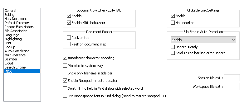

      I’ve seen a few threads on this already but they were older and didn’t seem to have current solutions. I did check the settings mentioned in those threads in the preferences/misc section and the box is checked for enabling the option.

        Maybe you should try turning off Clickable Link Settings, exit all instances of Notepad++, run one instance of Notepad++, enable the setting again, and see if it works. Then exit and run again and make sure it still works.
        If it doesn’t work for you, you will have to give us more information, including the ? menu Debug Info, like I showed above.
