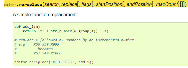

                        Alan Kilborn @astrosofista
                        @astrosofista said in Replacing number with another Incrementing #:
                        very minor adaptation of a code posted by @ekopalypse to solve a similar problem
                        so all credits belongs to him
                        Actually, I think all of the credit goes back to the Pythonscript documentation!
                        Note, though: number should be int in the documentation!
                        EkopalypseE PeterJonesP astrosofistaA 3 Replies Last reply Reply Quote 3
                          Ekopalypse @Alan Kilborn
                          @Alan-Kilborn @astrosofista
                          More specifically, I have modified the result of calling help(editor.rereplace) in the PythonScript console.
                          Help on method rereplace:
                          rereplace(...) method of Npp.Editor instance
                              rereplace( (Editor)arg1, (object)searchRegex, (object)replace) -> None :
                                  Regular expression search and replace. Replaces 'searchRegex' with 'replace'.  ^ and $ by default match the starts and end of the document.  Use additional flags (re.MULTILINE) to treat ^ and $ per line.
                                  The 'replace' parameter can be a python function, that recieves an object similar to a re.Match object.
                                  So you can have a function like
                                     def myIncrement(m):
                                         return int(m.group(1)) + 1
                                  And call rereplace('([0-9]+)', myIncrement) and it will increment all the integers.
                            @Alan-Kilborn said in Replacing number with another Incrementing #:
                            That documentation bug was fixed in v1.5.3 in February.
                            v1.5.4 has been released since, with the fix to the getLanguageDesc() historical bug which we finally reported in #146.
