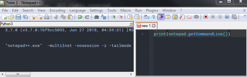

                    • EkopalypseE Offline
                      I was wrong, there is a way to provide user parameters.
                      By this we could start npp with something like notepad++.exe -multiInst -nosession -z -tailmode
                      and would be able to get it up and running

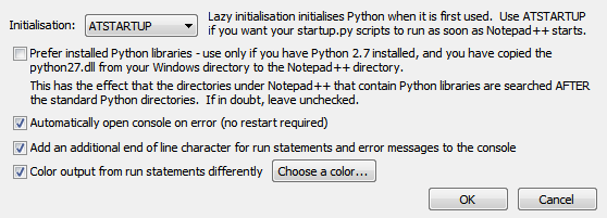

                        This PS, saved as startup.py (user NOT machine and PS configuration changed from LAZY to ATSTARTUP) should do the trick
                        from Npp import notepad, MENUCOMMAND
                        if '-tailmode' in notepad.getCommandLine():
                            notepad.menuCommand(MENUCOMMAND.VIEW_MONITORING)
                        and npp like this notepad++.exe -multiInst -nosession "FULL_PATH_OF_THE_FILE" -z -tailmode
