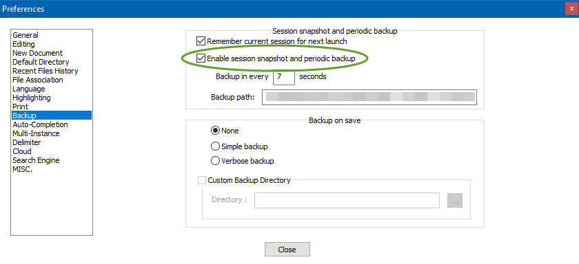

        Alan Kilborn @Jack Adrian Zappa
        @Jack-Adrian-Zappa
        Verify this setting is ticked:
        But…there have been reports of catastrophic data loss from some users when running this way.
        My advice is to always save (yourself) your documents to disk.
        And to perform your own backups.
        Caveat Emptor.

          • Jack Adrian ZappaJ Offline
            Jack Adrian Zappa @Alan Kilborn
            @Alan-Kilborn Hmmmm. So this setting wasn’t checked off, but that means that some update turned it off, which isn’t good.
            Has anyone discovered why the backup hasn’t worked in the past? I would think that should be a priority to fix.
              @Jack-Adrian-Zappa said in Notepad++ losing unsaved documents:
              Maybe “some update” was pretty smart, protecting you from features currently in question. :-)
              There’s been some attempts.
