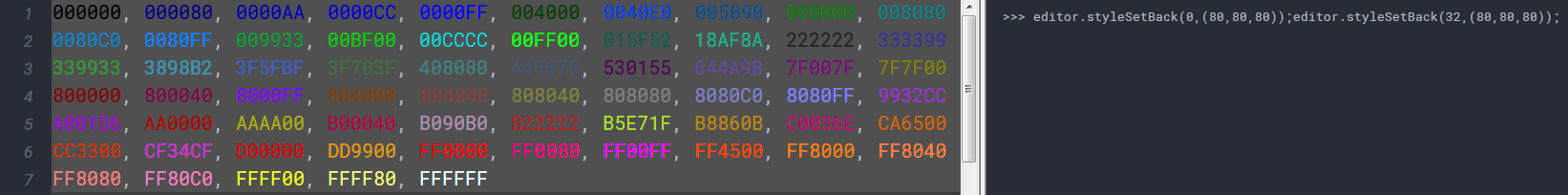

                              I have a question, in the screenshot below the background color is set to 80, 80, 80.
                              But why can I see the 7th hex value in the 4th line?
                              Fore- and background color should be the same, right?
                              Any ideas?
                                PeterJones @Ekopalypse
                                @Ekopalypse said in Default styler vs. Themes:
                                mspaint color picker tells me the background is set to decimal 80,80,80, and the foreground is set to hex 0x80,0x80,0x80.
                                edit: yeah, your pythonscript is calling with decimal arguments, not hex.
                                  Ekopalypse @PeterJones
                                  oh my … not a good sign … maybe should stop scripting for today :-D
                                  Thank you Peter.
