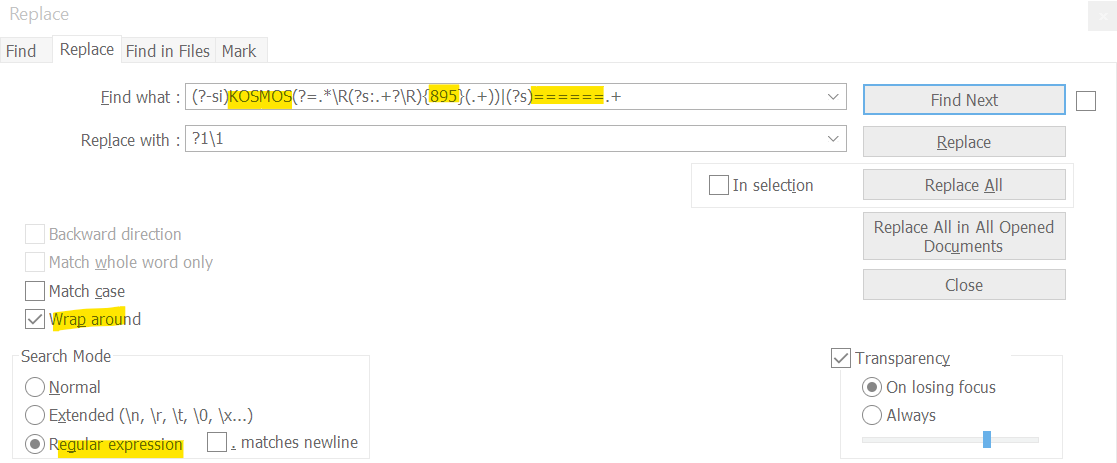

          Hallo @guy038 ,
          Thank you very much for your quick support. Your solution is exactly what I wanted to have. But, I have played with my files but it did not work out and I could not get the same result as yours. So, I would like to make my question is clearer.

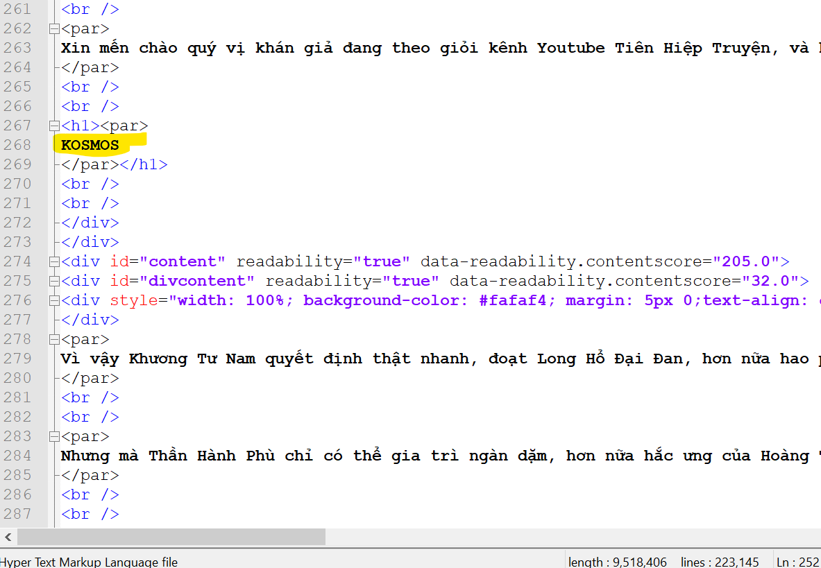

          My file a have 895 “KOSMOS” and they are placed in a single line. And, this is the first one.
          So, I would like to replace the first “KOSMOS” by the file line in my file b.
          And then, it will repeat the procedure until the last “KOSMOS” with line 895 in file b.
          So,…

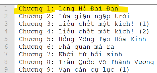

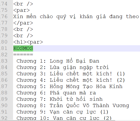

          • I copy the content of file a started from first “KOSMOS” and end with the last KOSMOS one, then I pasted to a new tab.
          • I appended this new tab with 895 lines from file b.
          • I followed your instructions but I could not the expected results.
            In my opinion, the problem could be the number of lines of file a-copied content does not exactly match to file b. However, I am not so sure and I also do not have any idea to deal with it.
          Could you please give me a suggestion?
          Many thanks in advance!
          Kosmos

              Ah…, of course, It cannot work because, there are a random number of lines between each KOSMOS line ! So, here is an other method which should work fine, although it contains numerous steps ;-))
              To begin with, from your pictures, I noticed that your file A contains 223,145 lines and I assume that your file B contains 895 lines only

              • After the 895 lines of file B, add a separation line with, at least, 3 consecutive equal signs, so the string === with a line-break
              • Then paste the contents of the clipboard, with Ctrl + V ( so the 895 lines KOSMOS of file A )
              Thus, the contents of file B should contain 895 lines before the ===: line and 895 after ( 5, in our example )

              • Perform the following regex S/R, in the Replace dialog ( Ctrl + H )
                • SEARCH (?-si).+(?=\R(?s:.+?\R){5}(.+))|(?s)===.+ ( Of course, use the quantifier {895}, instead of {5}, with your present file B )
                • REPLACE ?1\1$0
                • Option Wrap around ticked and Regular expression selected

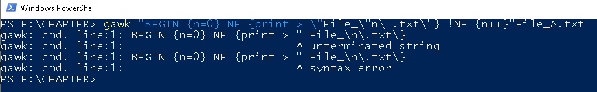

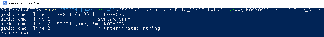

                        Sorry that I made you and others confused. I have another purpose which is totally different from my previous question. It means that I have two copies of file A. The one I wanted to split into multiple files based on “KOSMOS”. The other is used for my previous question. They are totally different questions.
                        Best regards,
                        Kosmos
                          Hello, @hientwi, @astrosofista and All,
                          Sorry to be late ! So OK : these are two tasks absolutely different !
                          Well, as you would like to manage file’s creation, regexes are not a nice tool for such a task. Personally, I would use the Gawk application. So, if you do not have this program, yet :
                          • Create a new folder
                          • Download the gawk-5.0.1-w32-bin-zip archive from    https://sourceforge.net/projects/ezwinports/files/
                          • Double-click on the gawk-5.0.1-w32-bin-zip archive
                          • Double-click on the bin folder
                          • Extract only the 5 files gawk.exe, libgmp-10.dll, libmpfr-4.dll, libncurses5.dll and libreadline6.dll in the new folder
                          • Copy your file A in that folder, which will be renamed as File_A.txt
                          • With N++, just add a line KOSMOS, at the very beginning of File_A.txt
                          • Open a DOS cmd window
                          • Type in and run the following command :
                            • gawk "BEGIN {n=0} $0!=\"KOSMOS\" {print > \"File_\"n\".txt\"} $0==\"KOSMOS\" {n++}" File_A.txt
                          • Wait a few moments … …
                          Et voilà ! You should see, in this new folder, 895 files from File_1.txt to File_895.txt ;-))
                          • Change, in your File_A.txt, each KOSMOS line into a pure empty line, with the regex :
                            • SEARCH (?-i)^KOSMOS(?=\R)
                            • REPLACE Leave EMPTY

                              Today, I have tried your first solution (File_B.txt which contains KOSMOS) and I got the error as in the following:
                              It is the same with your second solution with File_A.txt with blank line) as well.
                              Could you please kindly give me a favor?
                              Bests,
                              Kosmos

                                Dear @guy038 ,
                                I got the solution by correct quotations as the followings:
                                gawk ‘BEGIN {n=0} NF {print > “File_“n”.txt”} !NF {n++}’ File_A.txt
                                Best regards,
                                Kosmos.
