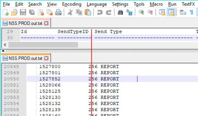

      I use Notepad++ to review “wide” listings and keep a fixed header at the top (Thanks to this post). I clone the file to another view, rotate left to get one view on top of the other, resize the top view to show the listing header lines then synchronize horizontal scrolling. This more-or-less works. The problems I have is that the listing header lines are at a point in the file where the line numbers are 2 digits and when I get way down in the file the line numbers are 5 digits and the columns don’t align. This becomes most annoying with many “narrow” columns in the listings. I’ve included a screen shot to show the basic alignment problem.
        Alan Kilborn @thompsop
        @thompsop
        One thing that could be done, if you’re willing to use a plugin, would be to use the Pythonscript plugin, specifically the editor.setMarginWidthN(margin, pixelWidth) function call. With this you could set both views’ line number margins to be the same, so they would again vertically line up.
        The editor object acts on the currently active view, but you can also use editor1 and editor2 objects to affect specific views.
        Clearly you’d want to set a fairly wide margin so that the actual line number value is much smaller than the width.
        The margin value for the line numbers is zero.
        In summary, you might do something like this:
        editor1.setMarginWidthN(0, pixelWidth)
        editor2.setMarginWidthN(0, pixelWidth)
        Not sure what the best pixelWidth value would be for you. It would take some experimentation I guess.
        This is probably all possible with the NppExec plugin as well, and maybe even @dinkumoil 's ExtSettings plugin?

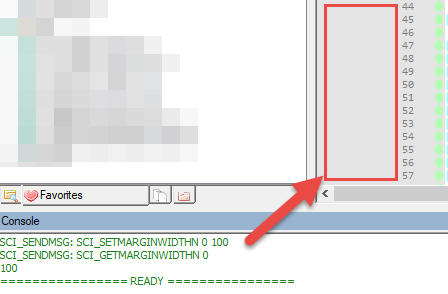

                  Using NppExec:
                  SCI_SENDMSG SCI_GETMARGINWIDTHN 0
                  ================ READY ================
                  ECHO $(MSG_RESULT)
                  32
                  So the width of the Notepad++ line number margin is 32. Let’s just change it:
                  SCI_SENDMSG SCI_SETMARGINWIDTHN 0 100
                  ECHO $(MSG_RESULT)
                  32
                  Wait, what? I set it to 100 and it visibly didn’t change and querying it, it’s still 32. Let’s try margin 1, the bookmark margin:
                  SCI_SENDMSG SCI_GETMARGINWIDTHN 1
                  ECHO $(MSG_RESULT)
                  16
                  SCI_SENDMSG SCI_SETMARGINWIDTHN 1 100
                  ECHO $(MSG_RESULT)
                  100
                  Yep, that worked and i can visibly see the margin is huge. I there some magic hocus pocus that is preventing resizing of the Notepad++ line number margin (margin 0)?
                  Alan KilbornA Michael VincentM 2 Replies Last reply Reply Quote 1
                    Alan Kilborn @Michael Vincent
                    @Michael-Vincent said in Need the ability to have fixed-width line number column:
                    Hmmm, worked for me! :

                        Outstanding! It may be a plugin I have that is causing issue? I have quite a few and some that muck with margins (like Changed Lines).

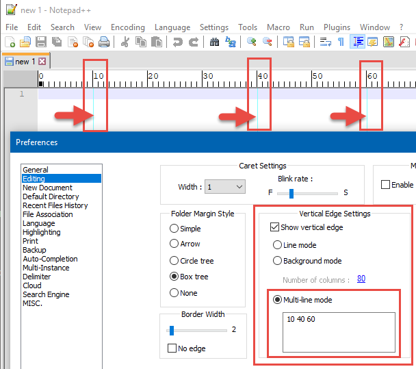

                                          (Scintilla multiedge)
                                          You mentioned “multiedge” briefly above; I agree that this could definitely help the OP. And, it appears a native multiedge capability is coming soon to Notepad++ !
                                          See https://github.com/notepad-plus-plus/notepad-plus-plus/pull/8107 and :
