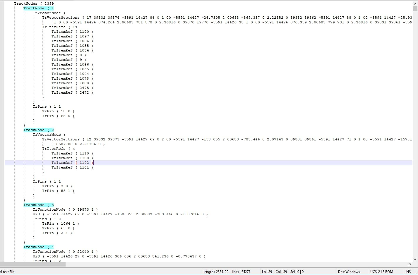

      Hi everyone!
      I’m in this situations. I’ve got this string called “tracknode”. It repeats 2399 times in progression.
      So i need to copy these 2399 “tracknodes” into the end of another file following another progression. So i want to change the “tracknode” progression to obtain this situation.
      I’m looking for a method to replace automatically this tracknode string progression because it repeats 2399 times.
      Thanks
      Paolo

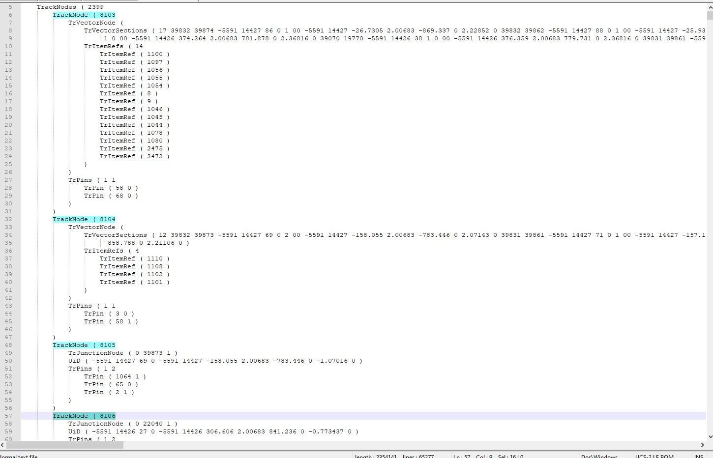

                  Hello, @paolo-serpi, @astro-sofista, @alan-kilborn and All,
                  Here is an alternative solution to your problem, which uses regular expressions !
                  Assuming this small input text, below :
                  TrackNodes (2399
                      TrackNode ( 1
                          TrVectorNode (
                              blab blah
                              blab blah
                          TrPins ( 1 1
                              blah blah
                              blah blah
                      TrackNode ( 2
                          TrVectorNode (
                              blab blah
                              blab blah
                          TrPins ( 1 1
                              blah blah
                              blah blah
                      TrackNode ( 3
                          TrVectorNode (
                              blab blah
                              blab blah
                          TrPins ( 1 1
                              blah blah
                              blah blah
                  • Put the caret at beginning of line TrackNodes (2399
                  • SEARCH (?-is)(TrackNode\x20\(\x20)\d+|\R(?!.*?TrackNode)
                  • REPLACE ?1\1><:|
                  Immediately, we get the text :
                  TrackNodes (2399
                      TrackNode ( ><|        TrVectorNode (|            blab blah|            blab blah|        )|        TrPins ( 1 1|            blah blah|            blah blah|        )|    )
                      TrackNode ( ><|        TrVectorNode (|            blab blah|            blab blah|        )|        TrPins ( 1 1|            blah blah|            blah blah|        )|    )|
                  Remark : I assume that the Vertical bar char ( | ), which replaces any line-break, does not exist, yet, in your file. If it’s not the case your may use, in the replace field, any other single standard char, not present in your file !
                  Now, it’s almost obvious :
                  • Put the caret on the first line TrackNode, between the two symbols > and <
                  • Open the column editor ( Alt + C )
                  • Select the choice Number to insert
                  • Type in the number 8103 as initial number
                  • Type in the value 1, as increment
                  • Type in the value 1, as Repeat sequence
                  • Do not tick the Leading zeros box
                  • Click on the OK button
                  • If necessary, delete the very last line, with the number only !
                  You should get :
                  TrackNodes (2399
                      TrackNode ( >8103<|        TrVectorNode (|            blab blah|            blab blah|        )|        TrPins ( 1 1|            blah blah|            blah blah|        )|    )
                      TrackNode ( >8104<|        TrVectorNode (|            blab blah|            blab blah|        )|        TrPins ( 1 1|            blah blah|            blah blah|        )|    )
                      TrackNode ( >8105<|        TrVectorNode (|            blab blah|            blab blah|        )|        TrPins ( 1 1|            blah blah|            blah blah|        )|    )|
                  • Finally, perform the following regex S/R :
                  SEARCH [<>]|(\|)
                  REPLACE ?1\r\n ( or ?1\n if you work with UNIX files ! )
                  And…, here is your expected text :
                  TrackNodes (2399
                      TrackNode ( 8103
                          TrVectorNode (
                              blab blah
                              blab blah
                          TrPins ( 1 1
                              blah blah
                              blah blah
                      TrackNode ( 8104
                          TrVectorNode (
                              blab blah
                              blab blah
                          TrPins ( 1 1
                              blah blah
                              blah blah
                      TrackNode ( 8105
                          TrVectorNode (
                              blab blah
                              blab blah
                          TrPins ( 1 1
                              blah blah
                              blah blah
                  If you like it, I’ll explain the regexes’s syntax, next time ;-))

                      @astrosofista I installed the PS script following the discussion linked by @Alan-Kilborn, but i can’t run PS like you said at point 2.
                      Can you explain better how i can do it?
                      I try the method of @guy038 and works perfectly.
