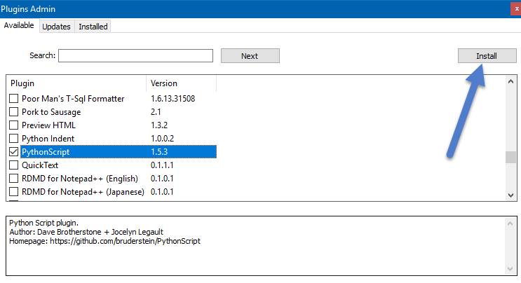

            Thank you very much. I never used Python, though. Which plugin do I need in notepad++ for this script?.
              Alan Kilborn @NiceGlassesDude
              @NiceGlassesDude
              Gosh. I thought I was fairly explicit about it, but here you go:
