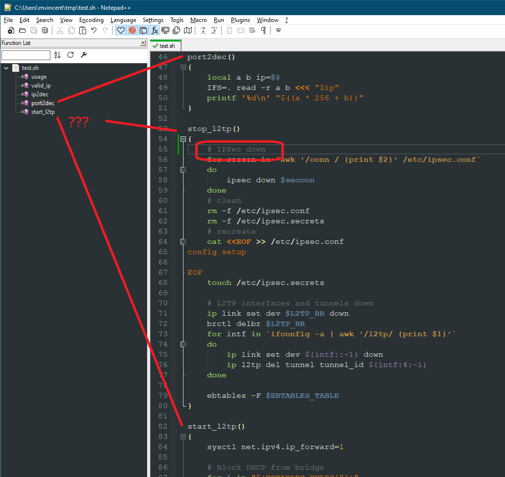

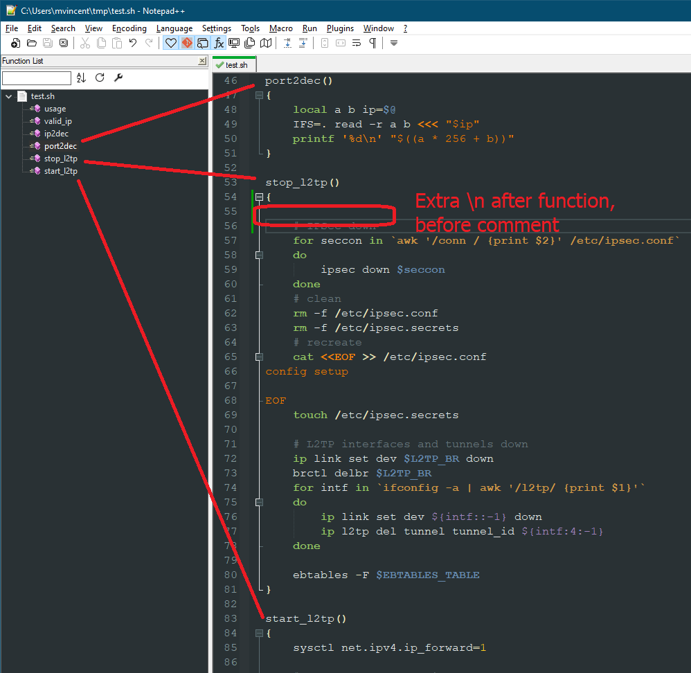

                  Michael Vincent @MAPJe71
                  @MAPJe71 said in Function List with Bash scripts not fully populating:
                  Still no problem for me with
                  Using your ‘bash.xml’ in my ‘functionList’ directory, I still see the issue:
                  The code used:
                  port2dec()
                      local a b ip=$@
                      IFS=. read -r a b <<< "$ip"
                      printf '%d\n' "$((a * 256 + b))"
                  stop_l2tp()
                      # IPSec down
                      for seccon in `awk '/conn / {print $2}' /etc/ipsec.conf`
                      do
                          ipsec down $seccon
                      done
                      # clean
                      rm -f /etc/ipsec.conf
                      rm -f /etc/ipsec.secrets
                      # recreate
                      cat <<EOF >> /etc/ipsec.conf
                  config setup
                  EOF
                      touch /etc/ipsec.secrets
                      # L2TP interfaces and tunnels down
                      ip link set dev $L2TP_BR down
                      brctl delbr $L2TP_BR
                      for intf in `ifconfig -a | awk '/l2tp/ {print $1}'`
                      do
                          ip link set dev ${intf::-1} down
                          ip l2tp del tunnel tunnel_id ${intf:4:-1}
                      done
                      ebtables -F $EBTABLES_TABLE
                  start_l2tp()
                      sysctl net.ipv4.ip_forward=1
                      # Block DHCP from bridge
                      for i in "${EBTABLES_RULES[@]}"
                      do
                          ebtables -I $i
                      done
                  MAPJe71M 1 Reply Last reply Reply Quote 2
