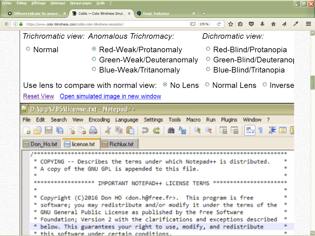

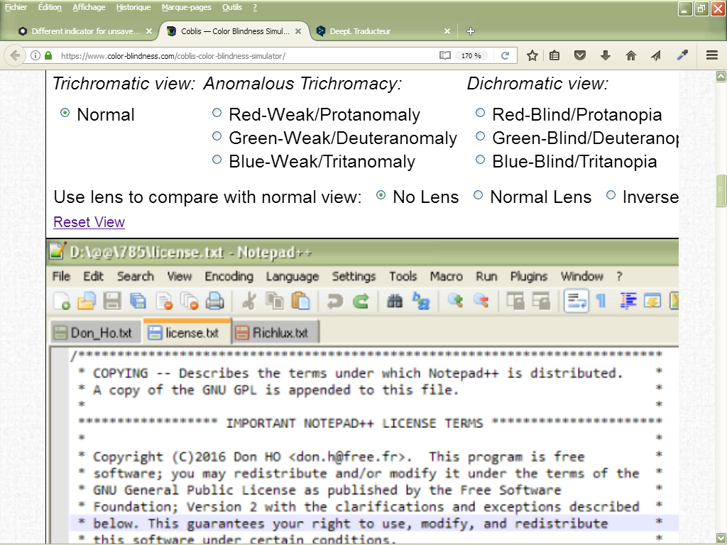

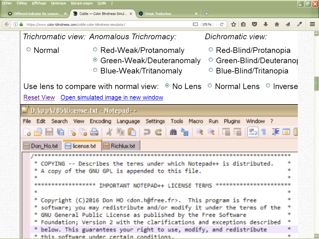

                            Hello, @richlux, @alan-kilborn, @peterjones, @astrosofista and All,
                            Generally speaking, there are about 8.3 % of colour-blind people, among the world population !
                            All these people can be broken down into the different groups, below, with their proportions :
                                Anomalous Trichromacy :                       Dichromatic view :                          Monochromatic view :
                            Red-Weak/Protanomaly        1%             Red-Blind/Protanopia        1%             Monochromacy/Achromatopsia  < 0.0001%
                            Green-Weak/Deuteranomaly    5.2%           Green-Blind/Deuteranopia    1.1%           Blue Cone Monochromacy        0.001%
                            Blue-Weak/Tritanomaly       0.0001%        Blue-Blind/Tritanopia       0.008%         Rod Monochromacy              0.003%
                            This means that, roughly, 92.7% of people have a normal vision
                            To understand the colour problems, faced by colour-blind people, here’s what they actually see when Notepad++ is opened with three tabs, on a Win XP laptop :
                            • The first one, with a file to save ( Richlux.txt )
                            • The second one, with a file already saved ( license.txt )
                            • The third one, with a read-only file ( Don-Ho.txt )
                            Here are the screen-shots of Notepad++, as seen by the main groups, with these visual impairments and people with normal vision :
                            • Normal vision ( ~ 92,7% ) :
                            • Red-Weak/Protanomaly ( ~ 1% ) :
                            • Green-Weak/Deuteranomaly ( ~ 5.2% ) :
                            • Red-Blind/Protanopia ( ~ 1% ) :
                            • Green-Blind/Deuteranopia ( ~ 1.1% )
                            As you can see, it is far from being simple for this category of people and every developer should pay attention to this aspect when developing his software !
                            Note that I got these screenshots, with the help of a color-blind simulator, below :
                            https://www.color-blindness.com/coblis-color-blindness-simulator/
                            Alan KilbornA richluxR 2 Replies Last reply Reply Quote 2
