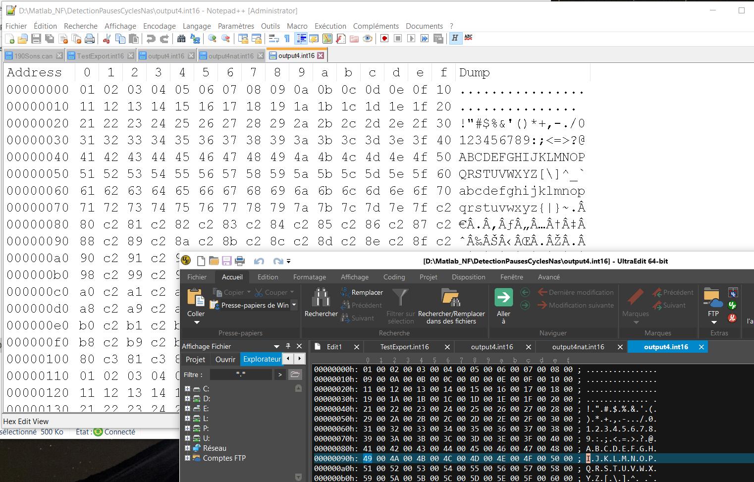

      Hello,
      I open a binary file with NotePad++ Hexa extension and with an other Hexa editor, and I do not get the same result. I best agree with the other one, as the file was generated with the code below, on matlab :
      Signal = zeros(4*64000,1);
      t=1;
      for i=1 : 4000
      Signal(t) = mod(t,200);
      t=t+1;
      end
      FileID = fopen(fullfile(pwd, ‘output4.int16’), ‘w’);
      fwrite(FileID,Signal,‘int16’);
      fclose(FileID);
      Where is the problem ?
      Thanks for the time you will take to consider my interrogation
      Cédric Freycenon

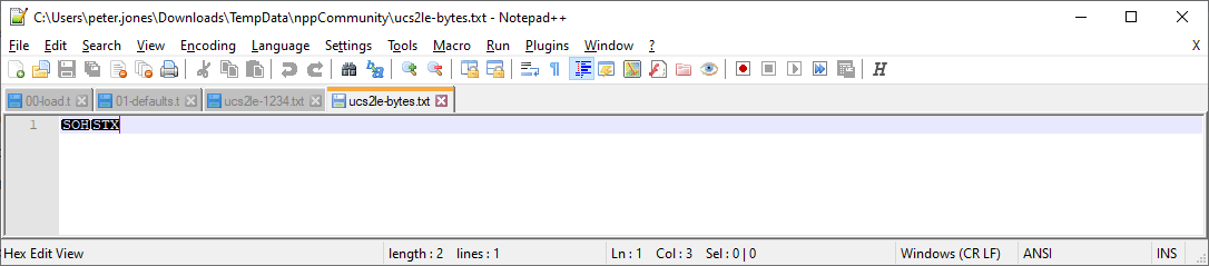

        However, when I create a binary file with the bytes 01 00 02 00,
        C:\Users\peter.jones\Downloads\TempData\nppCommunity>perl -e "print qq(\x01\x00\x02\x00)" > ucs2le-bytes.txt
        C:\Users\peter.jones\Downloads\TempData\nppCommunity>xxd ucs2le-bytes.txt
        00000000: 0100 0200                                ....
        Notepad++ sees that as auto-interpreted UCS-2 Little Endian (without BOM):
        And the hex editor plugin only displays the hex of the characters, rather than the hex of the indivdual bytes:
        When you stop viewing in hex, the plugin sent back the characters, not the original bytes, and now Notepad++ thinks it’s a normal ANSI file:
        and if i save that to disk, it has gotten rid of the 00 bytes:
        00000000: 0102                                     ..
        So, unfortunately, it looks like somewhere in the handoff between Notepad++ and the Hex Editor plugin, a UCS-2 LE file without BOM gets converted to ANSI encoding instead of UCS-2 LE encoding, so it drops the zero bytes.
