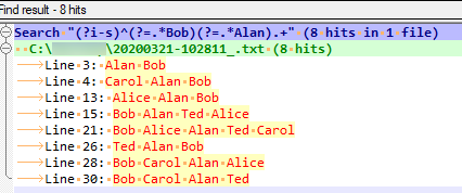

            Anyway, to show that what I provided does indeed work, I took this data:
            Alan
            Alan Carol
            Alan Bob
            Carol Alan Bob
            Bob
            Alice Ted Carol
            Ted Carol Alan
            Ted Carol Bob
            Alice Carol Bob
            Ted Carol
            Ted Alice
            Ted Bob
            Alice Alan Bob
            Alice
            Bob Alan Ted Alice
            Bob Carol
            Alice Carol Alan
            Carol
            Alan Ted
            Bob Alice
            Bob Alice Alan Ted Carol
            Bob Carol Ted Alice
            Alan Alice
            Alice Ted Alan
            Ted
            Ted Alan Bob
            Carol Alan Ted Alice
            Bob Carol Alan Alice
            Alice Ted Bob
            Bob Carol Alan Ted
            Carol Alice
            And I ran this search on it:
            Find what box: (?i-s)^(?=.*Bob)(?=.*Alan).+
            Search mode radiobutton: Regular expression
            Press the Find All in Current Document button
            Which is a search for “Bob and Alan on a line, in either order”.
            And I obtained these results:

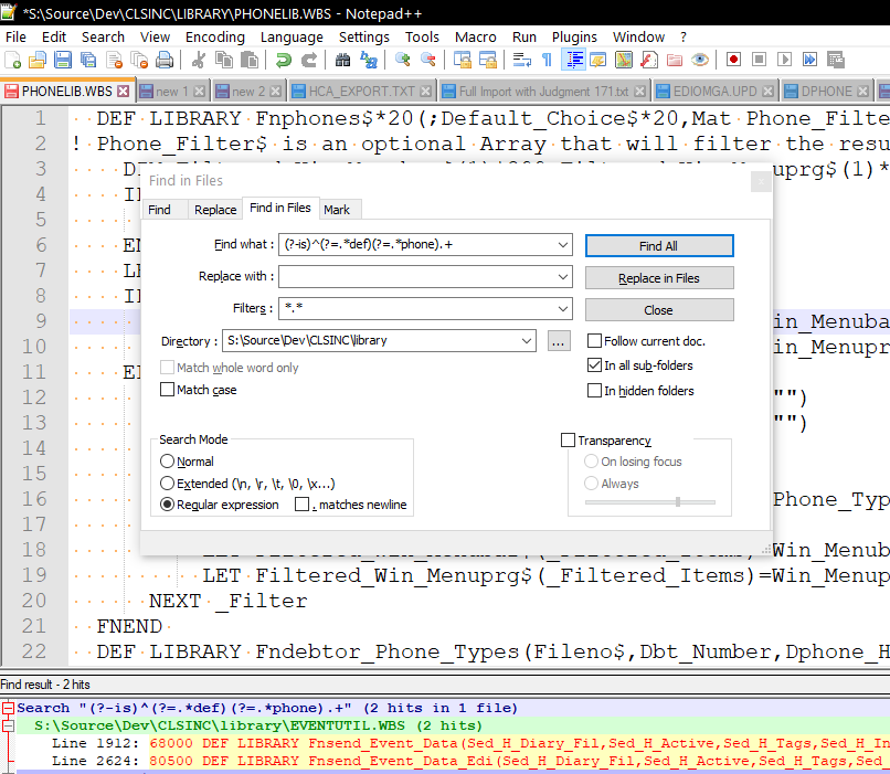

              I appreciate your assistance. As you’ll notice, the PHONELIB.WBS file contains both “DEF” and “PHONE” on lines 1 and 22 and is located in my search folder, yet the search string you provided did not find it as you can see from the results. Any thoughts on what I may have done wrong?
              Thanks.

                I think I understand where is the issue: you are searching in a non-insensitive mode (?-is), that is, in a sensitive way, when the correct mode is an insensitive mode, as (?i-s).
                HTH

                  Ahhhh, yes, that did the trick!
                  Thanks to you and Alan for the help.
                    My bad. I should have stated the original search like this, I suppose:
                    Find what box: (?-s)^(?=.*def)(?=.*phone).+
                    Match case checkbox: unticked or ticked <------ as you need
                    Not everyone knows that:
                    • leading off your regex with a variant of (?i) will search case INSENSITIVELY (the i is for Insensitive)
                    • leading off your regex with a variant of (?-i) will search case SENSITIVELY (the -i is for NOT [or “minus”] Insensive)
                    and that these little strings, if used, override the setting of the Match case checkbox, since they are logically processed after the checkbox setting.
