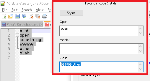

      I am creating a UDL. In the language I’m working with, all commands end with 999999. I’m having a problem with folding. It is not working properly when I define the term 999999 as the closing point. Is it possible to use as an closing folding point an expression containing only numbers?
        @André-Albuquerque said in Number expression as close folding point:
        Apparently not. At least, I can confirm with UDLv2.1.0.12 and NPP 7.8.4-64, if I define a UDL with Folding In Code 1 Open: open and Close: 999999 other, then it folds to other rather than 999999:

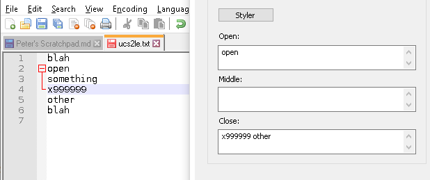

        if I change the close to x999999 other, and add the x to the data row, it now correctly folds to the x999999:
        I can confirm the apparent limitation, but I don’t know how to get around that. Sorry.
