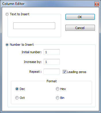

      I just want to improve on a old answer, because i just need to mix 2 files line by line and the answer in an old post from 2017 help me a lot. On file1 go to Edit -> Column Editor and insert numbers, the key (and the improvement) is to start with a high number bigger than the number of lines, so if you have 352 lines just use something like 1000 o 10000 (if you have more than 500 lines) and increase by 2 (thats very important also). Then on file2 add numbers in the same way but start at 1001 or 10001 also increased by 2. In this way, you got odds and even on different files, then you copy and paste one into another, do a sort line, then select the numberts using column mode an delete them.

            Hello, @fernando-sorensen, @peterjones and All,
            Indeed, very clever method, Fernando ;-))
            Now, assuming the input text, below, where I, deliberately, added some Tabulation or Space chars and sometimes none :
            1000	   		Line A in File 1
            1001	   		Line B in File 2
            1002Line C in File 1
            1003  Line D in File 2
            1004    Line E in File 1
            1005		Line F in File 2
            1006Line G in File 1
            1007	Line H in File 2
            1008 Line I in File 1
            1009	     Line J in File 2
            You may want to place the lines, of same number, in the same resulting line and delete the temporary leading numbers, in one go. If so, and assuming that your list begins with an even number, use the following regex S/R :
            SEARCH (?-s)^\d+[02468]\h*(.+)\R\d+\h*   OR   (?-s)^\d+[13579]\h*(.+)\R\d+\h* if the list begins with an odd number
            REPLACE \1\x20
            And you’ll get your expected output text :
            Line A in File 1 Line B in File 2
            Line C in File 1 Line D in File 2
            Line E in File 1 Line F in File 2
            Line G in File 1 Line H in File 2
            Line I in File 1 Line J in File 2
            The space separator character \x20, used in replacement may be changed to \t or \x20\x20\x20 or, even, \x20+\x20 !
            Of course, if you just would like to get rid of the temporary leadings blank chars, beginning each line, simply use :
            SEARCH ^\d+\h*
            REPLACE Leave EMPTY
            And, this time, you’re left with :
            Line A in File 1
            Line B in File 2
            Line C in File 1
            Line D in File 2
            Line E in File 1
            Line F in File 2
            Line G in File 1
            Line H in File 2
            Line I in File 1
            Line J in File 2
