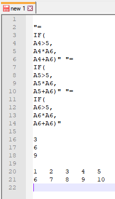

 I recently installed notepad++ and I really like it. I have no issues with notepad it self. The problem is that it seem to have change some kind of setting that I need reset. IDK how familiar anyone is here with excel but there is this kind of “tirck” if you will, where you copy and paste the formulas of entire rows or columns, and paste them into notepad. from there you can copy again, and paste them into another excel workbook and it keeps the exact formulas without ANY changes into the same rows/columns. This is helpful because if you copied the forumulas from one workbook to another, the references will be linked back to the source workbook.The problem is that now notepad no longer keep the same (excuse my lack of technical term) spacing. what once used to be in the same continious line now is now staggard. which is definetly much much easier to read BUT it prevents me from copying to excel correctly. I tested notepad in another computer thinking notepad had recently received an update or something. Well the other computer has no issues. I decided to email me the notepad file and when I opened it in my pc, it had changed “format” into the type that I cant copy into excel. it seems to be the way im viewing the file because it only looks diferent in my pc…odd If you guys could help me get back the old format or find a notepad app that hard forces this please. I tried like 2 other notepad apps and they have the same problem

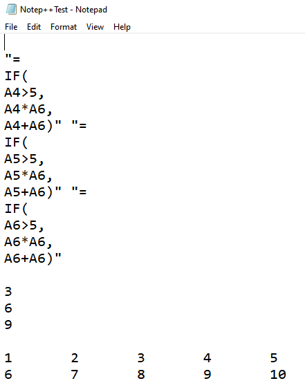

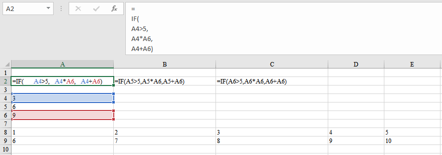

 Just to clarify the OP, I only have issues copying the formulas and I am copying them by first enableing Formulas > Show Formulas. Without it enabled, you can only copy the product of the formula.In the example below, you will probably notice that I am formating the formula so it can be easily read/understood instead of it all being in one line. I can confirm that on other PCs, this is not an issue (see 3rd picture)  This is how the above gets pasted into NPP. as you can see, it keeps the same formatting as in the formula bar in excel

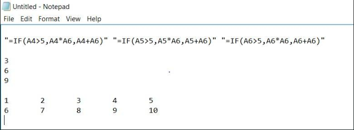

  Here is the same exact file pasted into notepad but from a different computer
  Here is that exact prior notepad file opened in my pc:  You might be asking yourself, why would someone need this capablility. Well if I was to copy the fourmulas directly from one workbook to another, the fourmulas will be linked to the source workbook. so A4 is now [sourceworkbook]sheetnumber!A4. any help is apreciated!

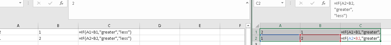

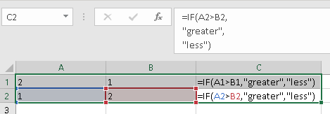

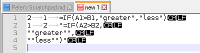

 I am at a machine with Excel now. If I take a couple of simple formulas – where row 1 has no newlines in the formula, but row2 has newlines:  and paste into notepad++, with View > Show Symbols > Show All Characters:

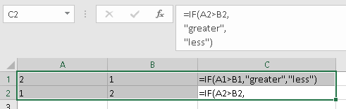

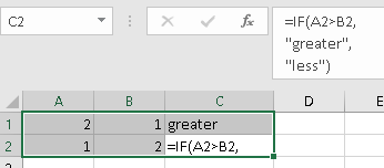

  if I select all that from Notepad++, and paste into a new sheet in Excel, I get:
 but when I don’t show formulas, I see that Excel actually treated the multiline formula as text:

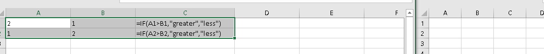

  Unfortuantely, because you didn’t show spaces-and-tabs, like I described in my first response, and you didn’t show all-characters (which might help with newlines, in case that’s influencing things), it’s hard to tell what’s different in the screenshots you showed. When I try the same experiment, but use the ms windows’s notepad.exe as the intermediary instead of Notepad++, it does the same thing. Which means the problem is not something specific to Notepad++, but is completely up to Excel. My guess is that you have some setting or version different in Excel between the two machines. But since it does the same thing for me, whether I use Notepad++ or notepad.exe for the intermediate step, it’s not a Notepad+±specific problem, and not really something where we can be expected to have expertise. (My screenshots today are from an active-subscription Office365 ProPlus Excel:  To be helpful: if I copy from one workbook to another, starting with:
 and pasting, to get:
  I get all the right formulas, without prefixing with [sourceworkbook]name.So, you seem to have differences in two versions of Excel, and Excel settings in such a way that the source name is copying. I cannot explore different Excel settings for you, but can confirm that with the way mine is set up, copying from one workbook to another doesn’t make it link the data: the formula stays local to the workbook. These are Excel problems, not something specific to Notepad++, so from here on out, you should probably move to an Excel forum. You should probably ask one or two questions – which are separate ideas, though the second isn’t as important now that you know that Excel should be able to handle the copy/paste with formulas correctly. -
