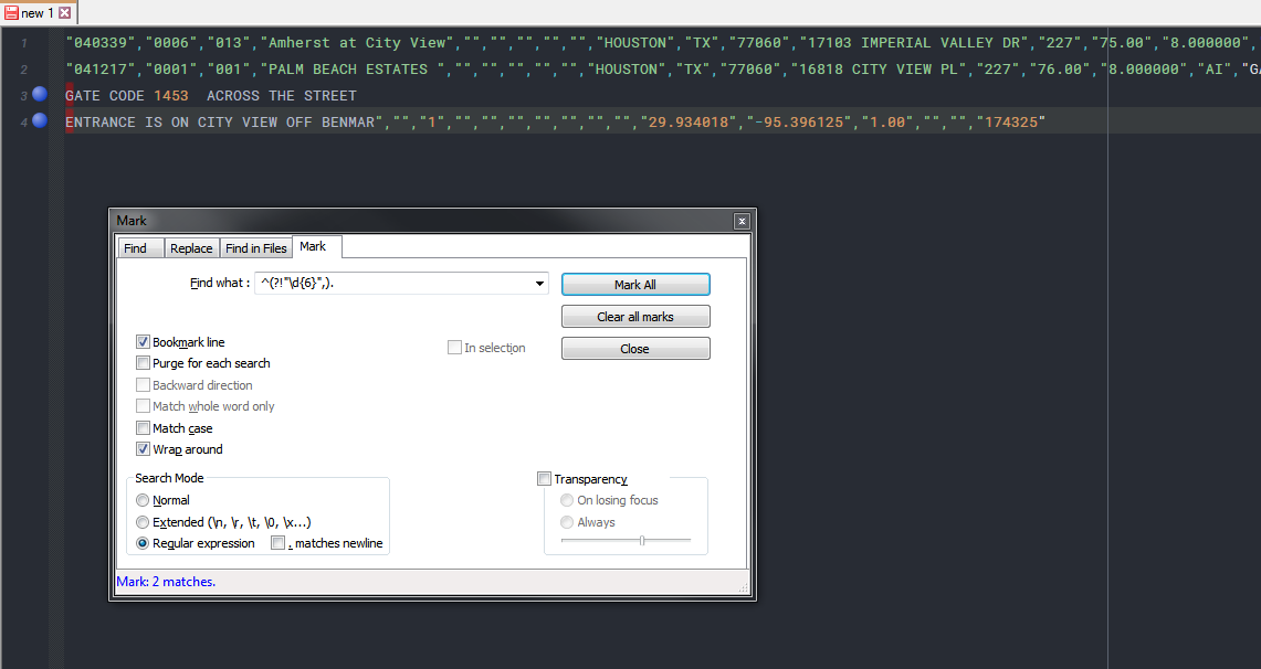

            Thanks for the quick responses Alan. I tried both of your suggestions on a file that has the offending records in it, but neither suggestion found those particular lines. I don’t know if it is permissible or possible to send you a screen shot of what I’m talking about, to see if it sparks another idea.

                “040339”,“0006”,“013”,“Amherst at City View”,“”,“”,“”,“”,“”,“HOUSTON”,“TX”,“77060”,“17103 IMPERIAL VALLEY DR”,“227”,“75.00”,“8.000000”,“AI”,“gate code 2070”,“”,“1”,“”,“”,“”,“”,“”,“”,“”,“29.946850”,“-95.396846”,“1.00”,“”,“”,“174350”
                “041217”,“0001”,“001”,“PALM BEACH ESTATES “,””,“”,“”,“”,“”,“HOUSTON”,“TX”,“77060”,“16818 CITY VIEW PL”,“227”,“76.00”,“8.000000”,“AI”,“GATE CODE 1454 SECTION 1
                GATE CODE 1453 ACROSS THE STREET
                ENTRANCE IS ON CITY VIEW OFF BENMAR”,“”,“1”,“”,“”,“”,“”,“”,“”,“”,“29.934018”,“-95.396125”,“1.00”,“”,“”,“174325”
                I couldn’t paste the screen shot as it wouldn’t let me and I don’t see a compose box to do the rest of what you said. But the above is line 1 is good, line 2 is the start of the first bad record, meaning that there are carriage returns breaking the record of line 2 into lines 3 and line 4. I have to remove the carriage returns so that lines 3 and 4 move back up to line 2 as one complete record. I appreciate your help and hope I’m explaining this well enough. But it’s the “junk” record lines similar to lines 3 and 4 that I need to find since that line doesn’t contain “123456”,

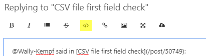

                  Paste your data here, select it here, and press this button (the one that I highlighted in yellow), right above the box you are composing in (called the “Compose” box):
                  If you don’t get a black-boxed version of your data, you haven’t done it right.

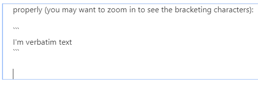

                      Hmmm. I use Snag-it as well sometimes and have never had a problem pasting image data here. You can try this with your data, too, to format it properly (you may want to zoom in to see the bracketing characters better):

                        "040339","0006","013","Amherst at City View","","","","","","HOUSTON","TX","77060","17103 IMPERIAL VALLEY DR","227","75.00","8.000000","AI","gate code 2070","","1","","","","","","","","29.946850","-95.396846","1.00","","","174350"
                        "041217","0001","001","PALM BEACH ESTATES ","","","","","","HOUSTON","TX","77060","16818 CITY VIEW PL","227","76.00","8.000000","AI","GATE CODE 1454  SECTION 1
                        ENTRANCE IS ON CITY VIEW OFF BENMAR","","1","","","","","","","","29.934018","-95.396125","1.00","","","174325"
                        Sorry- I figured out the issue. Now I’m using my local desktop. Previously I was using a remote server and apparently permissions are different. Thanks again.

                          @Alan-Kilborn 's regex seems to work for me
