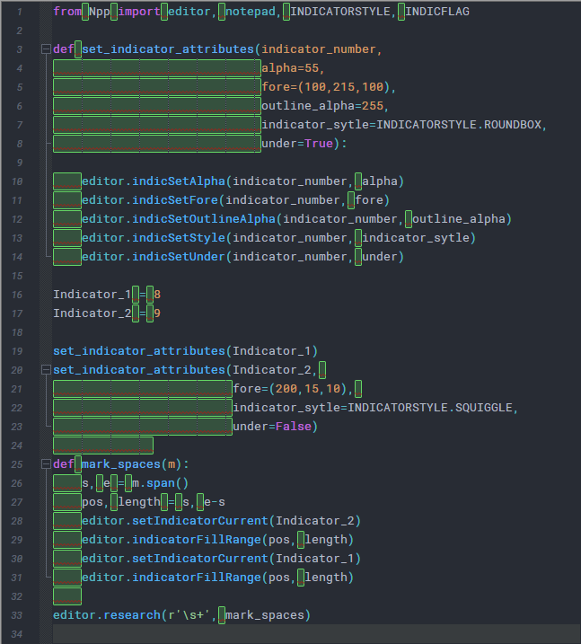

      just a test to see if two indicators can be used together.
      YES we can.

        To be honest, I never tried to use two [indicators]
        Just to clarify, I don’t need BOTH at the same time, I wanted to be able to use one for one group and another for another group (e.g. I’d prefer an underline for non zero-width chars so it’s not as visible as a box).
        I just wanted to differentiate between whatever the mark style is (I actually don’t know what exactly it is, is it always INDIC_ROUNDBOX that turns into a vertical line for zero-width chars?) and a user-defined style that you mention (INDIC_SQUIGGLE) as I thought these could be two different implementations:
        1. the mark style could be invoked via a “open search → mark menu → insert search string → select mark all” type of command and the other style
        2. the other style would be applied “directly” to the regex strings found by the script

                Thanks a lot for the script, it’s working great!
                Just a few questions:
                1. Is it possible to make the script toggle itself? This way I’d can click a menu button to turn it on/off
                2. Also, is there a chance to add the bookmark as an option for a regex group as I don’t need them for all the characters, but only for some?
                3. During performance testing I’ve noticed that ~100 of characters would make it choke and slow down caret movement refresh rate, i.e. if I hold the Right key (without any edits and without moving the screen buffer), the caret would disappear and appear only when I release it (the position would change). I was wondering whether this is due to it auto-updating too fast or someting and if the script could maybe poll for changes slower? Granted, in real documents I never have so many of characters for this script to work with, so it’s not a big issue
                  Ekopalypse @eugenesvk

                  Point 1 + 2 should be implemented now,
                  Concerning point 3, this might have several causes.
                  One, from what I recall is a change within scintilla.
                  If scintilla receives too many keyboard inputs it won’t repaint until a key release has been received BUT it could be python as well.
                  Second, if you have really long lines this is an internal known scintilla issue.
                  What I did was changing one regex to search for \w+ and using the script itself and it seem to be reasonable fast if I stayed on up/down arrow key.
                  One other thing, the bookmarking is somewhat slow and I don’t know why.
                  Currently, well some month already, I’m developing a new pythonscript plugin,
                  one which uses python3 and if I do bookmarking with this plugin,
                  it instantly does it.
                  eugenesvkE 1 Reply Last reply Reply Quote 2
