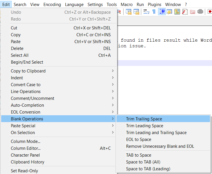

          Hello @cletos and All,
          I think that @andrecool-68 made a little mistake in his answer !
          From your post, you’ll have to perform the option :
          Edit > Blank Operations > Trim Trailing Space
            Alan Kilborn @andrecool-68
            @andrecool-68
            With that solution, you’ve give the OP more than they’ve asked for. The better operation, to do only what was required, is this one:

              Thank you, andrecool-68,
              Works great.
              Hello guy038,
              That option does it very good as well, thank you. Thanks Alan.
