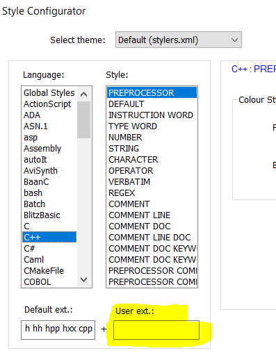

      c++ syntax for all files - how i can do this?
      I disabled all syntaxes except с++, but this does not work.
        Alan Kilborn @wS Стас
        @wS-Стас
        Well, you might try defining what “all files” really means by putting their extensions here:
        • wS СтасW
          wS Стас
          Yes, for examle i have “php” in “User ext” and anyway it’s not working.
          https://prnt.sc/qyiwft
          I think because: https://prnt.sc/qyiuyr
          I can’t edit left side (“default ext”). When i open .php file, i have .php highlighting.
          • wS СтасW
            wS Стас
            https://prnt.sc/qyiyo0
            I turned off all languages except c++, and even this does not help, the .php file opens with .php highlighting. It’s stupid… Exist properties “-l cpp <file>”, but how i can do this for all files?

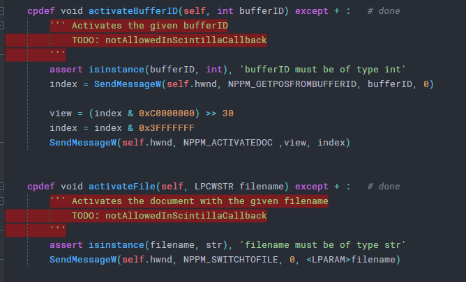

                      In order to make this work, that every programming language file, as far as notepad++ knows it,
                      displays its comment in the same color and font you have to go through each defined language
                      and reconfigure there comment line settings.
                      Another alternative might be to explicitly mark those lines like here
                      Might be possible by recording a macro - didn’t try it.
                      Or using a scripting language like @PeterJones mentioned.
