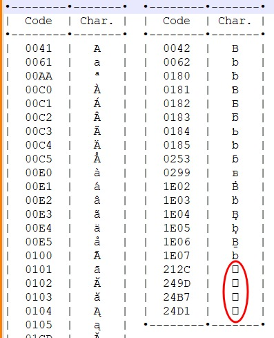

         Different characters found, with the EQUIVALENCE Class [[=X=]], where X is the FIRST or SECOND char of each COLUMN
        |  Code  | Char. |  |  Code  | Char. |  |  Code  | Char. |  |  Code  | Char. |  |  Code  | Char. |  |  Code  | Char. |
        |  0041  |   A   |  |  0042  |   B   |  |  0043  |   C   |  |  0044  |   D   |  |  0045  |   E   |  |  0046  |   F   |
        |  0061  |   a   |  |  0062  |   b   |  |  0063  |   c   |  |  0064  |   d   |  |  0065  |   e   |  |  0066  |   f   |
        |  00AA  |   ª   |  |  0180  |   ƀ   |  |  00C7  |   Ç   |  |  00D0  |   Ð   |  |  00C8  |   È   |  |  0191  |   Ƒ   |
        |  00C0  |   À   |  |  0181  |   Ɓ   |  |  00E7  |   ç   |  |  00F0  |   ð   |  |  00C9  |   É   |  |  0192  |   ƒ   |
        |  00C1  |   Á   |  |  0182  |   Ƃ   |  |  0106  |   Ć   |  |  010E  |   Ď   |  |  00CA  |   Ê   |  |  1E1E  |   Ḟ   |
        |  00C2  |   Â   |  |  0183  |   ƃ   |  |  0107  |   ć   |  |  010F  |   ď   |  |  00CB  |   Ë   |  |  1E1F  |   ḟ   |
        |  00C3  |   Ã   |  |  0184  |   Ƅ   |  |  0108  |   Ĉ   |  |  0110  |   Đ   |  |  00E8  |   è   |  |  2109  |   ℉   |
        |  00C4  |   Ä   |  |  0185  |   ƅ   |  |  0109  |   ĉ   |  |  0111  |   đ   |  |  00E9  |   é   |  |  2131  |   ℱ   |
        |  00C5  |   Å   |  |  0253  |   ɓ   |  |  010A  |   Ċ   |  |  018A  |   Ɗ   |  |  00EA  |   ê   |  |  2132  |   Ⅎ   |
        |  00E0  |   à   |  |  0299  |   ʙ   |  |  010B  |   ċ   |  |  018B  |   Ƌ   |  |  00EB  |   ë   |  |  24A1  |   ⒡   |
        |  00E1  |   á   |  |  1E02  |   Ḃ   |  |  010C  |   Č   |  |  018C  |   ƌ   |  |  0112  |   Ē   |  |  24BB  |   Ⓕ   |
        |  00E2  |   â   |  |  1E03  |   ḃ   |  |  010D  |   č   |  |  018D  |   ƍ   |  |  0113  |   ē   |  |  24D5  |   ⓕ   |
        |  00E3  |   ã   |  |  1E04  |   Ḅ   |  |  0186  |   Ɔ   |  |  0256  |   ɖ   |  |  0114  |   Ĕ   |  •--------•-------•
        |  00E4  |   ä   |  |  1E05  |   ḅ   |  |  0187  |   Ƈ   |  |  0257  |   ɗ   |  |  0115  |   ĕ   |
        |  00E5  |   å   |  |  1E06  |   Ḇ   |  |  0188  |   ƈ   |  |  02A4  |   ʤ   |  |  0116  |   Ė   |
        |  0100  |   Ā   |  |  1E07  |   ḇ   |  |  0254  |   ɔ   |  |  1E0A  |   Ḋ   |  |  0117  |   ė   |
        |  0101  |   ā   |  |  212C  |   ℬ   |  |  0255  |   ɕ   |  |  1E0B  |   ḋ   |  |  0118  |   Ę   |
        |  0102  |   Ă   |  |  249D  |   ⒝   |  |  0297  |   ʗ   |  |  1E0C  |   Ḍ   |  |  0119  |   ę   |
        |  0103  |   ă   |  |  24B7  |   Ⓑ   |  |  1E08  |   Ḉ   |  |  1E0D  |   ḍ   |  |  011A  |   Ě   |
        |  0104  |   Ą   |  |  24D1  |   ⓑ   |  |  1E09  |   ḉ   |  |  1E0E  |   Ḏ   |  |  011B  |   ě   |
        |  0105  |   ą   |  •--------•-------•  |  2102  |   ℂ   |  |  1E0F  |   ḏ   |  |  018E  |   Ǝ   |
        |  01CD  |   Ǎ   |                      |  2103  |   ℃   |  |  1E10  |   Ḑ   |  |  018F  |   Ə   |
        |  01CE  |   ǎ   |                      |  212D  |   ℭ   |  |  1E11  |   ḑ   |  |  0190  |   Ɛ   |
        |  01DE  |   Ǟ   |                      |  249E  |   ⒞   |  |  1E12  |   Ḓ   |  |  01A9  |   Ʃ   |
        |  01DF  |   ǟ   |                      |  24B8  |   Ⓒ   |  |  1E13  |   ḓ   |  |  01DD  |   ǝ   |
        |  01E0  |   Ǡ   |                      |  24D2  |   ⓒ   |  |  249F  |   ⒟   |  |  0204  |   Ȅ   |
        |  01E1  |   ǡ   |                      •--------•-------•  |  24B9  |   Ⓓ   |  |  0205  |   ȅ   |
        |  01FA  |   Ǻ   |                                          |  24D3  |   ⓓ   |  |  0206  |   Ȇ   |
        |  01FB  |   ǻ   |                                          •--------•-------•  |  0207  |   ȇ   |
        |  0200  |   Ȁ   |                                                              |  0258  |   ɘ   |
        |  0201  |   ȁ   |                                                              |  0259  |   ə   |
        |  0202  |   Ȃ   |                                                              |  025A  |   ɚ   |
        |  0203  |   ȃ   |                                                              |  025B  |   ɛ   |
        |  0250  |   ɐ   |                                                              |  025C  |   ɜ   |
        |  0251  |   ɑ   |                                                              |  025D  |   ɝ   |
        |  0252  |   ɒ   |                                                              |  025E  |   ɞ   |
        |  1E00  |   Ḁ   |                                                              |  0283  |   ʃ   |
        |  1E01  |   ḁ   |                                                              |  0285  |   ʅ   |
        |  1E9A  |   ẚ   |                                                              |  0286  |   ʆ   |
        |  1EA0  |   Ạ   |                                                              |  029A  |   ʚ   |
        |  1EA1  |   ạ   |                                                              |  1E14  |   Ḕ   |
        |  1EA2  |   Ả   |                                                              |  1E15  |   ḕ   |
        |  1EA3  |   ả   |                                                              |  1E16  |   Ḗ   |
        |  1EA4  |   Ấ   |                                                              |  1E17  |   ḗ   |
        |  1EA5  |   ấ   |                                                              |  1E18  |   Ḙ   |
        |  1EA6  |   Ầ   |                                                              |  1E19  |   ḙ   |
        |  1EA7  |   ầ   |                                                              |  1E1A  |   Ḛ   |
        |  1EA8  |   Ẩ   |                                                              |  1E1B  |   ḛ   |
        |  1EA9  |   ẩ   |                                                              |  1E1C  |   Ḝ   |
        |  1EAA  |   Ẫ   |                                                              |  1E1D  |   ḝ   |
        |  1EAB  |   ẫ   |                                                              |  1EB8  |   Ẹ   |
        |  1EAC  |   Ậ   |                                                              |  1EB9  |   ẹ   |
        |  1EAD  |   ậ   |                                                              |  1EBA  |   Ẻ   |
        |  1EAE  |   Ắ   |                                                              |  1EBB  |   ẻ   |
        |  1EAF  |   ắ   |                                                              |  1EBC  |   Ẽ   |
        |  1EB0  |   Ằ   |                                                              |  1EBD  |   ẽ   |
        |  1EB1  |   ằ   |                                                              |  1EBE  |   Ế   |
        |  1EB2  |   Ẳ   |                                                              |  1EBF  |   ế   |
        |  1EB3  |   ẳ   |                                                              |  1EC0  |   Ề   |
        |  1EB4  |   Ẵ   |                                                              |  1EC1  |   ề   |
        |  1EB5  |   ẵ   |                                                              |  1EC2  |   Ể   |
        |  1EB6  |   Ặ   |                                                              |  1EC3  |   ể   |
        |  1EB7  |   ặ   |                                                              |  1EC4  |   Ễ   |
        |  212B  |   Å   |                                                              |  1EC5  |   ễ   |
        |  249C  |   ⒜   |                                                              |  1EC6  |   Ệ   |
        |  24B6  |   Ⓐ   |                                                              |  1EC7  |   ệ   |
        |  24D0  |   ⓐ   |                                                              |  2107  |   ℇ   |
        •--------•-------•                                                              |  212E  |   ℮   |
                                                                                        |  212F  |   ℯ   |
                                                                                        |  2130  |   ℰ   |
                                                                                        |  24A0  |   ⒠   |
                                                                                        |  24BA  |   Ⓔ   |
                                                                                        |  24D4  |   ⓔ   |

          • V
            VERSEAU44
            Why have I this result (white rectangles) when I copy/paste tables in my NotePad++ ?
              PeterJones @VERSEAU44
              @VERSEAU44 said in Search accent-insensitive:
              Because your font (Notepad++ menu Settings > Style Configurator > Language: Global Styles > Style: Default Style > Font name) doesn’t include glyphs for those characters. You might be able to toggle Settings > Preferences > MISC > ☐ Use Direct Write and restart Notepad++, and it might help the OS grab glyphs from other fonts to use in Notepad++ when your active font doesn’t have a specific glyph.
