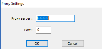

        Proxy address and port are going to be set by your local I.T. department. They aren’t specific to Notepad++, so you’ll have to find out what they are. If you aren’t behind any I.T. department it means YOU are the I.T. department, so you’ll have to figure out what you have set up (good luck).
        But yes, once you know the correct numbers, you have to run Notepad++ in administrator mode in order for this setup to matter:
        Obviously! don’t copy my zeros thinking it will work for you. :)

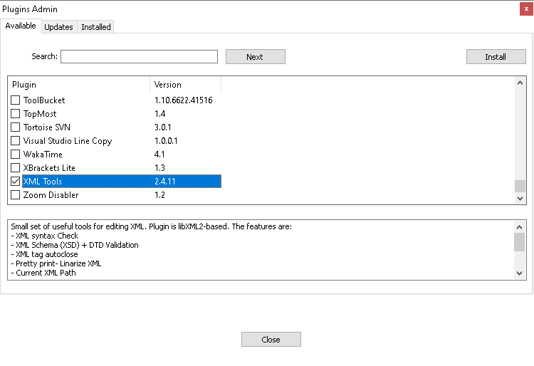

              @munchies34 said in Install button is greyed out?:
              I can see the full list of plugins, I can click on them and view the infos. But for every single plugin the install button is greyed out and I can’t click it.
              Back to your original question:
              I played around with the Plugins Admin a bit (no proxy!), and what I saw was that “click on” can have two different meanings. One leaves the Install button grey, the other activates it.
              1. Clicked on, but grey:
              2. Clicked on, and active:
              When you say “click on”, did you mean you clicked on the text, or you clicked on the checkbox and enabled it?
              You need the second variant to be able to install. (And you should be able to enable more than one simultaneously for multiple-plugin installation.)

                @PeterJones Lol I feel stupid. Yes, clicking the box fixed this issue. Thank you! Maybe if I can make a suggestion to put some text somewhere explaining to check a box. That might help someone who was as confused as I was. Thanks again for the help.
