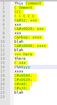

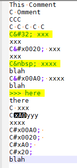

              Two problems with that: First, C  would be the non-breaking-space, which wouldn’t be the character that @jason1820 would use; it would be C . Second, that entry doesn’t fully use entities: when I have the following:
                          <Keywords name="Comments">00C&#32; 00C&nbsp; 00&gt;&gt;&gt; 00C&#x00A0; 00C&#xA0; 01 02 03 04</Keywords>
              it recognizes the entities for the >>>, but not for the space or NBSP:
              – it treats the &#32; and &nbsp; as literals (so if you have that literal text in your document, it will recognize those as comments), though it seems to recognize &#x00A0; and/or 00C&#xA0; as being something, but doesn’t match them when the NBSP character is present.
              Reminding myself, the Wikipedia article on character entities points out that XML only has a short list of pre-defined entities, compared to the fuller list of HTML entities: only "&'<> have default XML entities.

                          <Keywords name="Comments">00C&#32; 00C&nbsp; 00&gt;&gt;&gt; 00C&#x00A0; 00C&#x0020; 00C&#xA0; 00C&#x20; 01 02 03 04</Keywords>
              It appears to be treating the C&x#20; as C[space], but that then behaves like a normal space is there separating entries, so anything starting with C is commented again.
