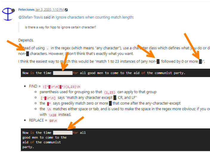

        @Stefan-Travis said in Ignore characters when counting match length:
        Is there a way for Npp to ignore certain character?
        Depends.
        Instead of using . in the regex (which means “any character”), use a character class which defines what you do or don’t want. For example, [^█]{1,23} would match 1-23 non-█ characters. However, I don’t think that’s exactly what you want.
        I think the easiest way to match this would be “match 1 to 23 instances of (any non-█, followed by 0 or more █)”.
        Now is the time ██████████for all good men to come to the aid of the communist party.
        • FIND = ([^█\r\n]█*){1,23}\h
          • parenthesis used for grouping so that {1,23} can apply to that group
          • [^█\r\n] says “match any character except █, CR, and LF”
          • the █* says greedily match zero or more █ that come after the any-character-except
          • the \h matches either space or tab, and is used to make the space in the regex more obvious; if you only want space but not tab to be included, replace that with \x20 instead.
        • REPLACE = $0\n
        party.

                      Any ideas when I look at this old posting, I see wackiness?
                      I don’t remember it looking this way originally.
                      Sample, where I point to some of what looks “wacky”:
                        @Alan-Kilborn said in Ignore characters when counting match length:
                        Actually, I think it probably did.
                        In the original post, Stefan said, “For instance with the full block character” – the “full block character” is U+2588 FULL BLOCK █. When I copied the character from the OP and pasted it in that website’s search, it matches that same character.
                          Ah, okay, I didn’t (re)read the old thread closely enough. I thought something was going wacky with my browser or the site. I was thinking that old thread might be useful HERE, but maybe I was stuck on the “one-step” approach in my thinking (I think @guy038 always has us thinking one-step!), but I like Terry’s multi-step thoughts for that thread now.
