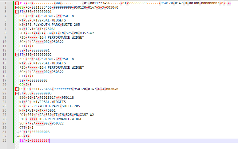

            hello! i found this thread during a Google search for EDI support for notepad++. it looks like your Github project hasn’t been updated in a few years. did you ever get X12 working? would love to try it
              PeterJones @Daniel L
              @Daniel-L ,
              Unfortunately, @innox80 hasn’t been back since February 2021, so it’s doubtful you’ll get a direct response.
              However, you are in luck: according to the N++ Issue#6173 that was linked above, the EDIFACT and X12 lexers are in the lexer library (Lexilla) that Notepad++ uses for syntax highlighting. Which means, they are what I call “hidden lexers”, and I’ve previously made a script for the PythonScript plugin which can enable hidden lexers.
              You can download the most recent version of the script from my repo for pythonscripts from this link: HiddenLexers.py.
              The script doesn’t yet enable the X12 lexer, but as I have time over the next day or two, I’ll work on it; I’ll post an update (either updating this post, or replying) once I have it available.
              If you could tell me the common filename extensions for X12 and/or EDIFACT, I can include those as I’m customizing the script.
              Once the script is updated, you can follow the instructions in our How to install and run a script in PythonScript, which will explain how to install the plugin and install and run the script. If you want the HiddenLexers.py script to automatically run whenever you launch Notepad++, make sure you follow the STARTUP instructions at the end of the INSTALLATION section of the FAQ, and you would need to import HiddenLexers in your startup.py script, as described in that section of the FAQ.
                I assumed the X12 EDI extension is .x12. The HiddenLexers.py download has been updated to enable the X12 lexer for all files ending in .x12.
                Since I know nothing about X12, I just found the example file used here (so I used the same .x12 file that Lexilla uses when testing their LexX12.cxx for the library that Notepad++ uses).
                I even was able to enable the folding (which is something I hadn’t tried in HiddenLexers to date).
                You can now follow the FAQ instructions for installing the plugin and running the script.
                If you don’t like the colors I chose (understandable), you can go to the line starting at editor.styleSetFore(self.SCE_X12_DEFAULT , and change the RGB triples for the foreground and/or the background. (If you change the colors: if you use the STARTUP version, you can exit notepad++ and rerun to get it to use the new colors; if you manually ran the script instead, you can just run the script twice more – the first will clear the old settings and the second will re-enable HiddenLexers using the new colors)
