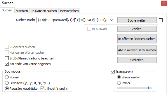

                Search field should look like this?
                Not sure about the search options you mentioned.
                Thanks for all guys!!!
                andrecool-68A 1 Reply Last reply Reply Quote 0
                • andrecool-68A
                  andrecool-68 @dipsi7772
                  @dipsi7772 You have the simple search tab open, and you need the following tabs of the search window, replace or find and replace in files

                            • dipsi7772D
                              dipsi7772
                              Is it maybe possible to implement a rule that avoids duplicate results?
                              Another thing is, even I choose “Automatischer Zeienumbruch” each line is writte ine ONE line, not in a second one which woud avoid the vertical scrolling.
                              Best Regards Friends
                                Hi, @dipsi7772 and All,
                                You said :
                                Strange thin is, on some files. just <!doctype html> this is the result.
                                I would say al files are the same format , so Its mystious.
                                It’s not strange and it’s not related to file format at all ! The reason, is that , for files with big size, it may happen that the regex does not work properly and deletes all characters but the first line of your HTML files. Indeed, as the regex is :
                                (?s).*?(?-si:pass(word)?.*?>(.+?)(?=</div>))|.+
                                The beginning (?s).*?(?-si:pass(word)? means that the regex engine selects all characters, even displayed on several lines, from current position of the caret till the first word pass or password. In some files, this range of characters can be significative and this fact could explain the non-expected results !
                                My question is : In the copied HTML files, that contains the passwords ( 1 per line ), which is the maximum length of these files ?
                                Depending of this length, a regex solution may be possible… However, if you don’t mind changing the initial order of these passwords, just use, for each copied HTML file, the two menu options, below :
                                • Edit > Line Operations > Sort Line Lexicographically Ascending
                                • Edit > Line Operations > Remove Consecutive Duplicate Lines
                                I’m sorry because I cannot guess what you’re speaking of :-(( Depending on your file ending characters, discussed previously, and using the appropriate Replace regex :
                                \2\r\n for Windows files
                                OR
                                \2\n for Unix files
                                The View > Word Wrap option should work correctly !?
